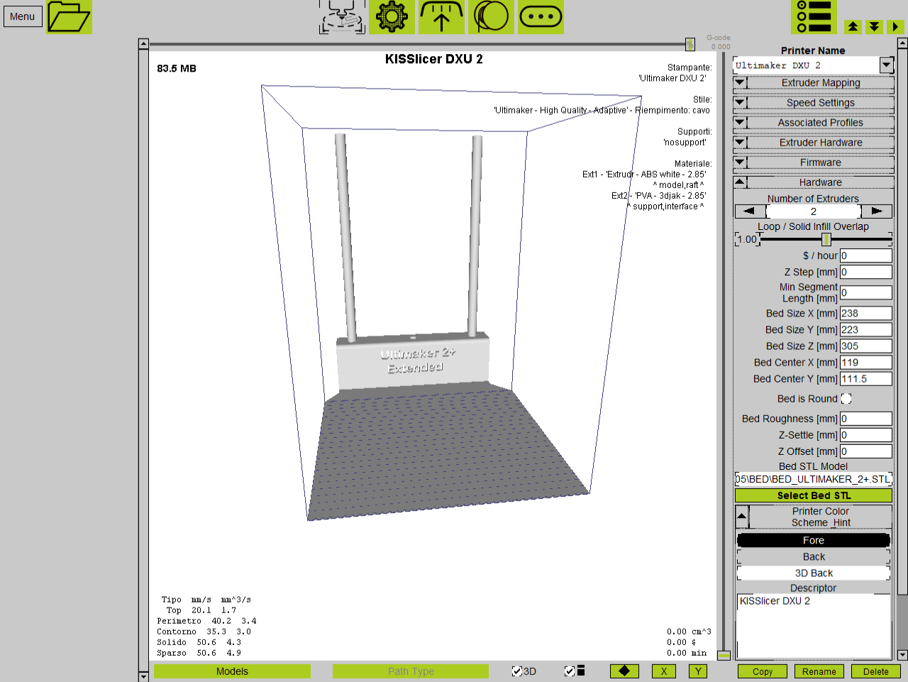

Ultimaker
- Bed_Ultimaker.png (129.03 KiB) Viewed 12167 times
- BED_ULTIMAKER_2+.zip
- (841.01 KiB) Downloaded 613 times
