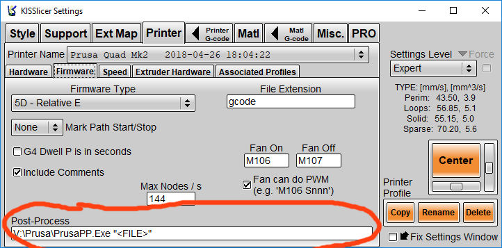

Is it possible to use the Settings/Printer/Firmware/Post-Process entry field for this?
Re: Ability to run script from within KISS
pjr wrote:Is it possible to use the Settings/Printer/Firmware/Post-Process entry field for this?
It is. That's how I upload and print from kisslicer on the duet.

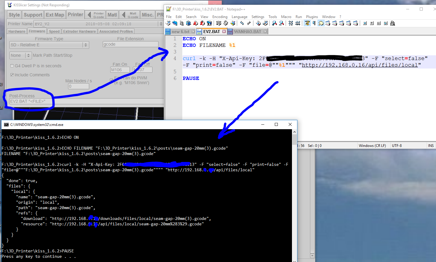

Post by sinned6915 »
[quote="pjr"]Is it possible to use the Settings/Printer/Firmware/Post-Process entry field for this?
It IS possible! We should move this from Feature requests to Tips & Tricks! Here is my script using curl. I got some assistance in final debug from Jubaleth on freenode reprap irc.
ECHO ON
ECHO FILENAME %1
curl -k -H "X-Api-Key: *YOUR_OCTOPRINT_API_HERE*" -F "select=false" -F "print=false" -F "file=@""%1""" "http://192.168.*.*/api/files/local"
PAUSE

The syntax that works in KISS_2.0 seems to be -
YOUR_SCRIPT.BAT "<FILE>"
YOUR_SCRIPT.BAT contains-
curl -k -H "X-Api-Key: **API_KEY**" -F "select=false" -F "print=false" -F file=@%1 "http://octoprint.local/api/files/local"
