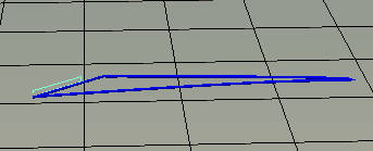

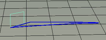

i am using the new release of KISSlicer 1.6, and have problems on some models.
I have tolde the nozzle to lift before a move up 0.3mm, and it does that on most moves.
But some moves act different, the nozzle is raised by a bigger value, the nozzle remains for a second or two at the high place, then it is lowered again and the print continues.
That has a bad result, cause my cooling-system is raised, too, and the printed PLA does not get the air as it should.
I have added tow pictures, taken from Repetier-Host, to show a normal move and a bad move.
Any suggestions? Is that a feature that i need to disable? Or is that a bug?
Thanks for your suggestions and answers!
Edit: Have found the GCode
; Post-layer lift
G1 X99.176 Y103.043 Z8.45 E0 F210
; END_LAYER_OBJECT z=3.700
; BEGIN_LAYER_OBJECT z=3.950 z_thickness=0.250
; Blending Fan to Cool (98.5% blend)
The head is not lifted to 4.25mm, it is lifted to 8.45mm, that is 4.2mm too much ...
