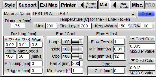

Re: CubeX PLA fans not running?
pingu wrote:Now PJ-Con colling fans turn on, but when I print PLA - no fans. :roll:
How much do you have for Fan Z [mm] into Matl table ?
Under Printer / Firmware is Fan ON = M106 ?
Send some screen shots of your settings
Post by moo00se »
The default is 200
Under Printer / Firmware is Fan ON = M106 ? Yes for me.
I have installed all of this fore the first time. I struggled with using 491 before i found this thread :lol: My first print with 6.05 the part fans did not run. The part is 12mm tall.
moo00se wrote:How much do you have for Fan Z [mm] into Matl table ?
The default is 200
If you set "Fan Z = 0 " the fan will start from first layer, if you set FanZ =0.4 and you have 0.2 for layer thickness the fan will not work for the first 2 layers and after the fan will be turned on.
