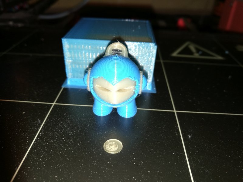

My first variable layer height multi-filament print:
Not great quality, but the tower is more important than the model at the moment.
