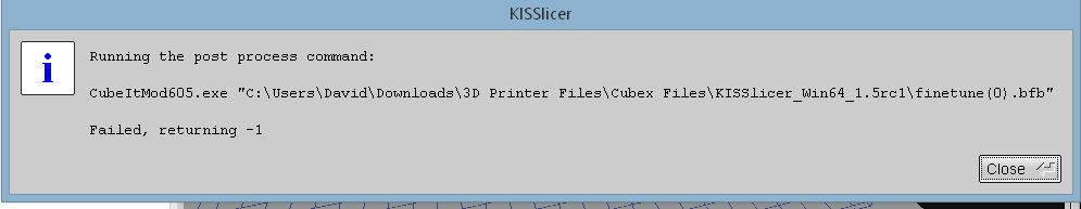

I'm new Cubex Duo owner and new to Kisslicer and Cubeitmod so please bear with me. When I go to save my file
everything seems to work right except the Post Process command.
I get the error message
Can anyone tell what I'm doing wrong?

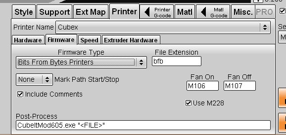

Please post a screen shot of your Printer/Firmware tab.

Here is my Printer/Firmware page
Re: Post Process Command Failed Returning -1
doc49 wrote:Yes, I can at least print now, thank you!
This looks OK.
If you run KS from a shortcut try to go into the KS folder and start KS by clicking directly on the exe file.
