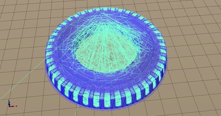

I'd like to see this feature too, especially when printing from flexible material (which don't like retraction).
In this case Cura engine creates better paths than Kisslicer.
I'd use Cura for this print, but it removes tiny details, including the circular support structures I've created for the interior of the tyre.
Kisslicer does a much better job retaining object details, but it produces unnecessary travels across the tyre, which result in "hairy" surfaces (the flexible material cannot retract properly).
Cura slicer
Cura slicer
Kisslicer 1.5 beta 3.6
Is there a way around this in Kisslicer now? I'd like to force the path generator to either keep the extruder inside the current slice's perimeter, or create an absolute minimal travel across several parts of the current slice.

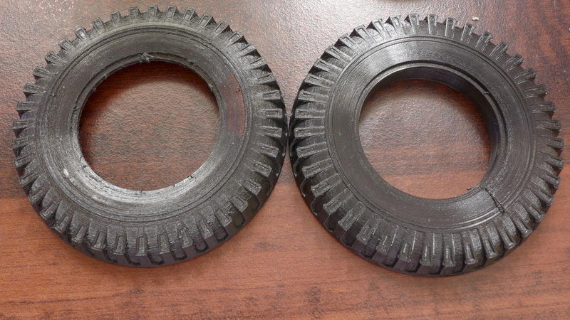

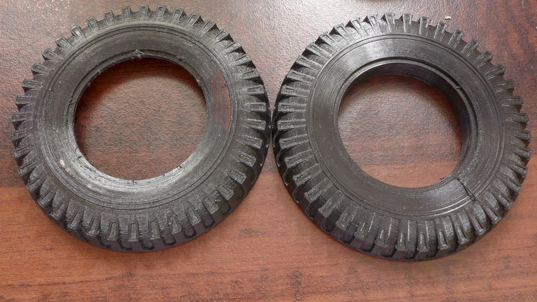

Unfortunately, right now I have to stick to Cura engine just for the tyres, because it creates a much nicer surface. That also means 21 hours of printing, instead of just 13 :( .
Left KISSlicer, right Cura<br />same temperatures, same print speed
