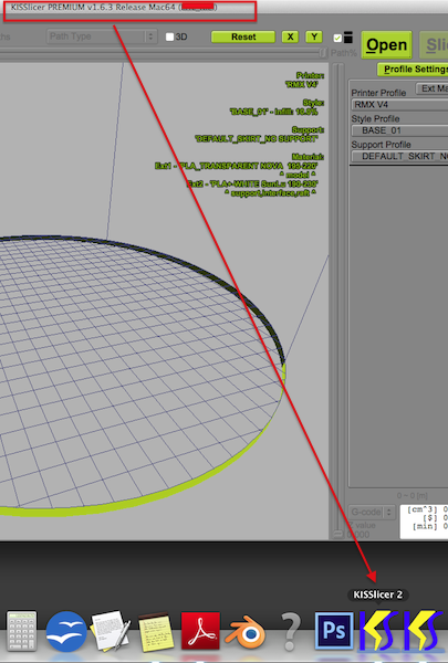

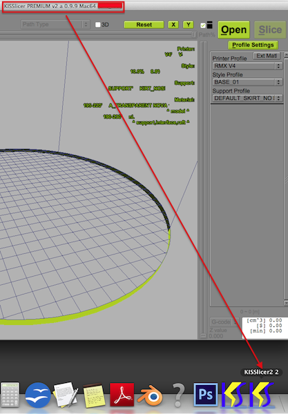

nurbie
Posts: 6
Joined: 26 Jul 2019, 12:57
Re: KISSlicer V2.0 Alpha Fault Reports
Post by nurbie »
just because y'all might want proof:
Screen Shot 2019-07-31 at 6.55.43 PM.png (195.92 KiB) Viewed 12873 times
Screen Shot 2019-07-31 at 6.56.22 PM.png (194.93 KiB) Viewed 12873 times
Witchcraft!
