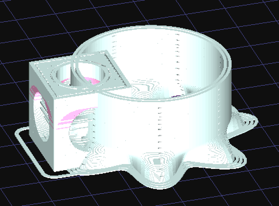

Re: KISSlicer V2.0 Alpha Fault Reports
Sometimes this happens:
Project and stuff attached. I'm not sure how reliably it is reproducible, sometimes I just change some minor bit and it places things better.
At any rate it's nice to see how gracefully it handles this placement ;-)
