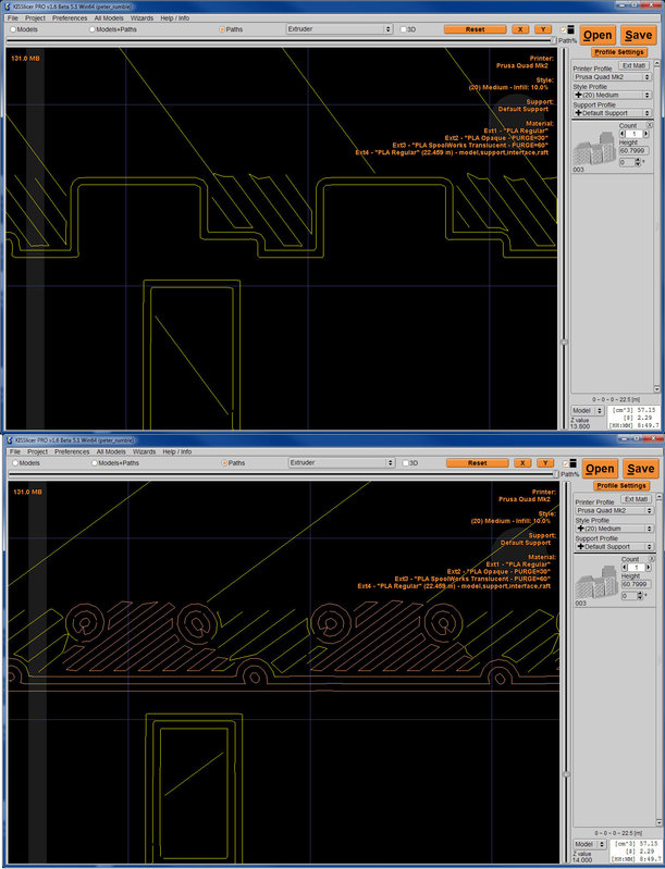

Hello Jonathan,
I find the bug from older releases reapearing in 1.6 RC1 today (circular artefacts).
Here are screens.
And below the link to stl to reproduce:
https://www.dropbox.com/s/yyvpywcilupyv62/003.zip?dl=0
Some guys from other forums also were talking about poor dimensional tolerances/control for internal holes (comparing to v1.4 and 1.5), but as none of such reports finally appeared here, I guess these may have been some early user errors.
Thanks for a fantastic work!!!

voyt wrote:Hello Jonathan,

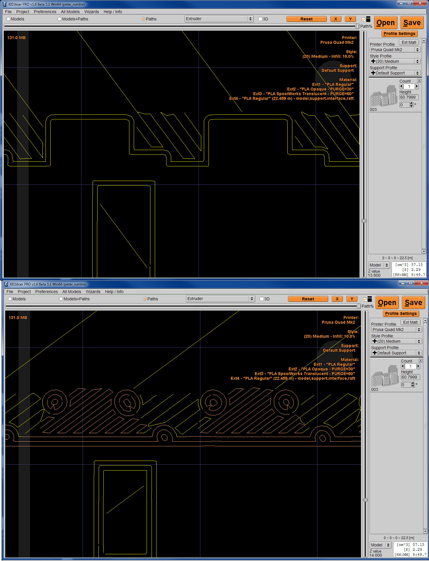

Maybe a better two-layer view of this issue:
Here are screens.
It's a fun now to read other software forums endless threads about retraction finetuning ;)
Thank you! Could you please also attach a KISSlicer Project file? (In the menu, [Project]->[Save Project As])

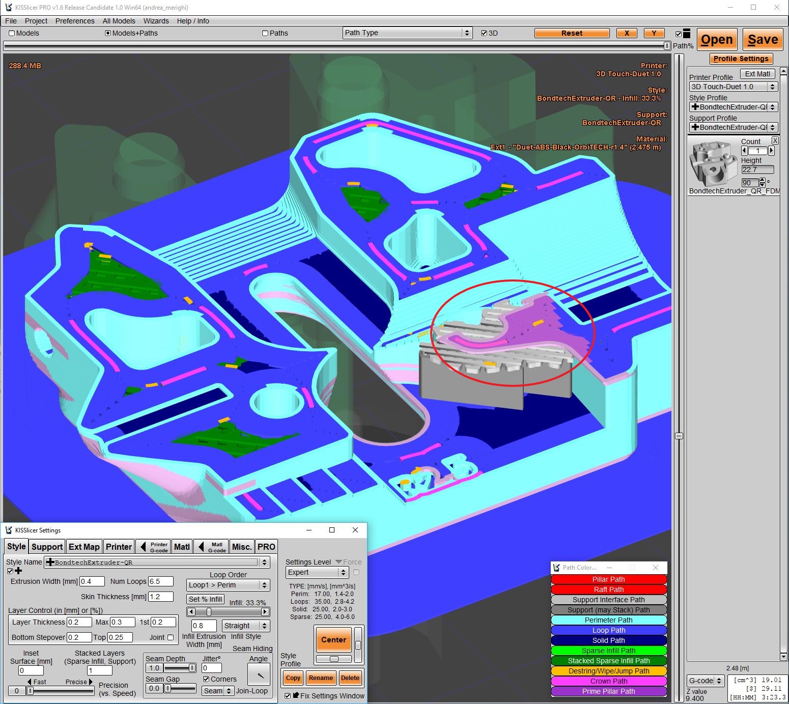

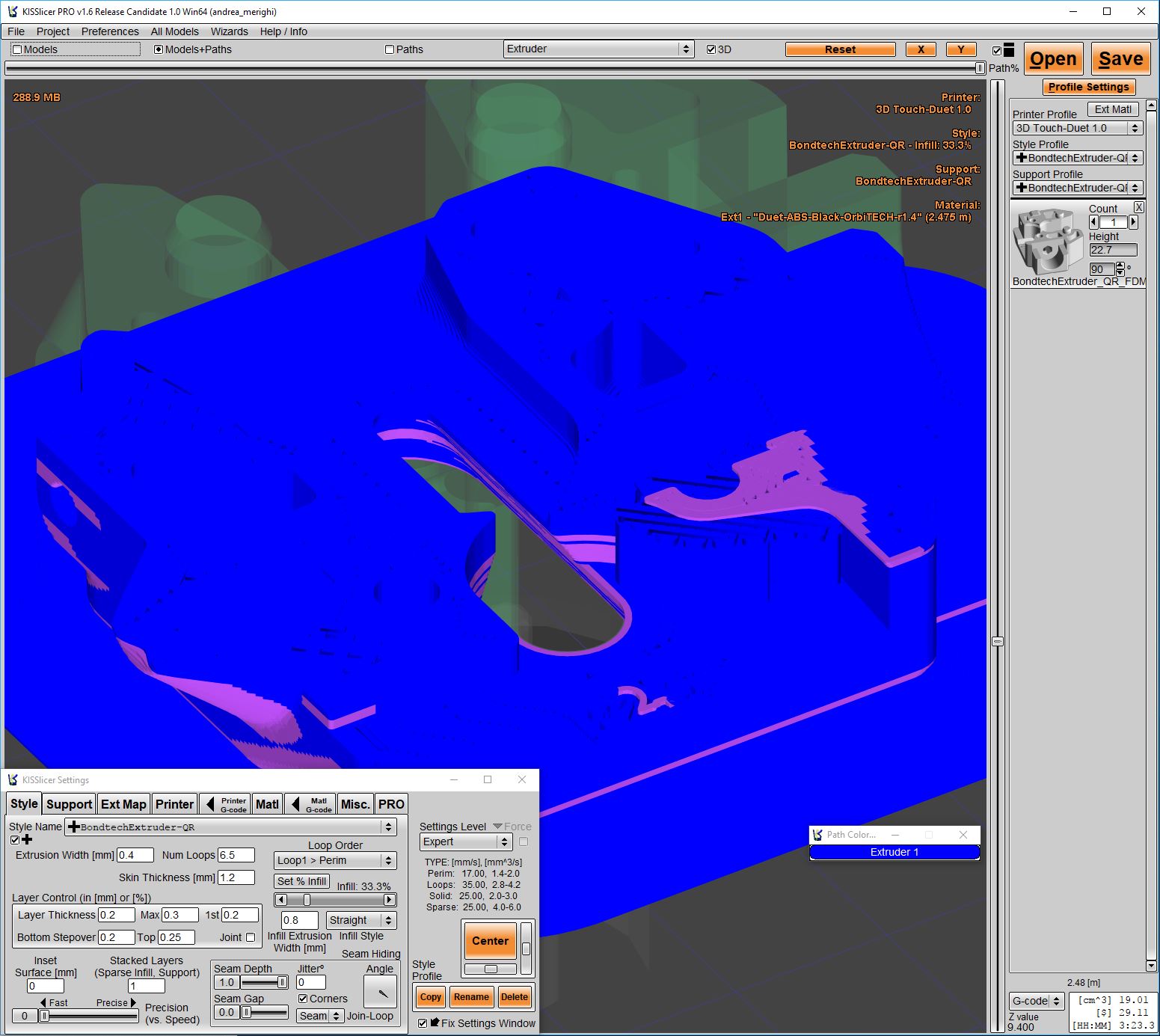

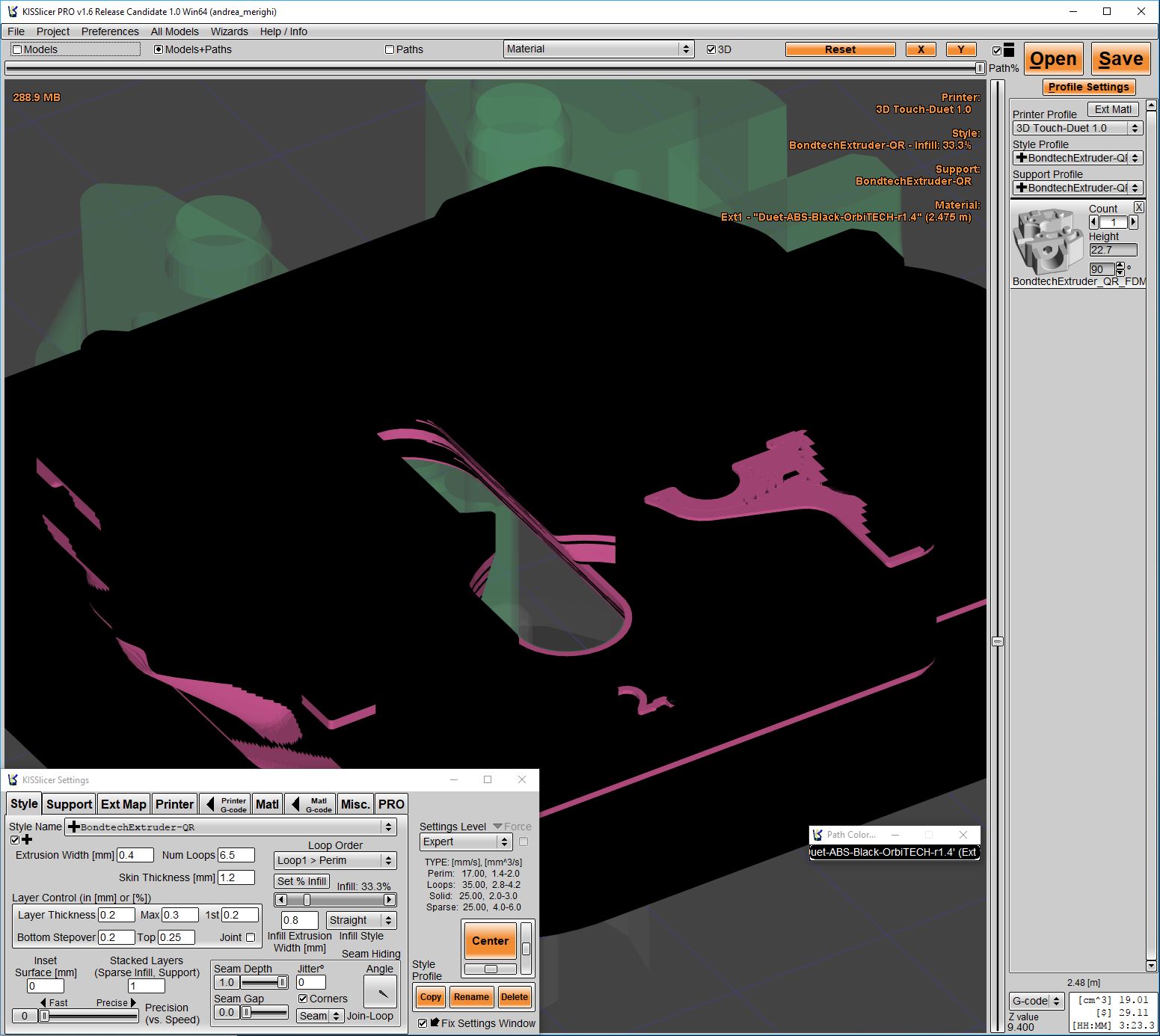

Hello Jonathan,
changing the visualization per path type, extruer or material a strange pink path remain visible.
Also the colours of that path are not present in the path colour key Windows (that differ from crown path).

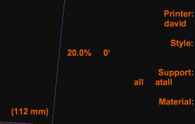

On mac things sometimes look like this:
Screen Shot 2017-08-18 at 21.48.59.png (21.79 KiB) Viewed 3396 times
Just parts of the text are wiped out. I don't have a way to reproduce it, just have kisslicer running for a while, slice this, slice that and then it happens.
