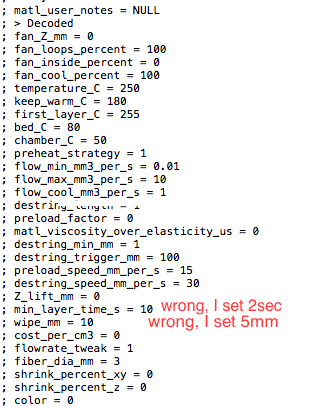

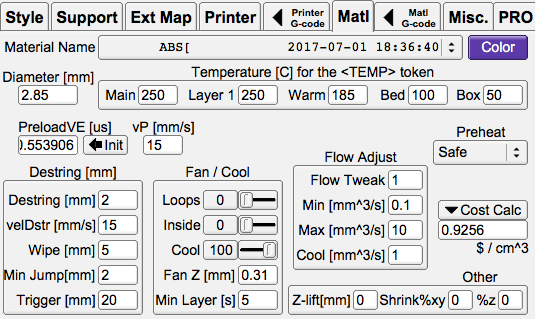

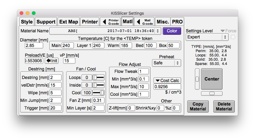

I think this is the same problem in my two reports.
Im using mac versions, looks like settings not applied.
My settings via UI
Settings in the gcode
Снимок экрана 2017-07-02 в 15.35.41.png (62.73 KiB) Viewed 23450 times
