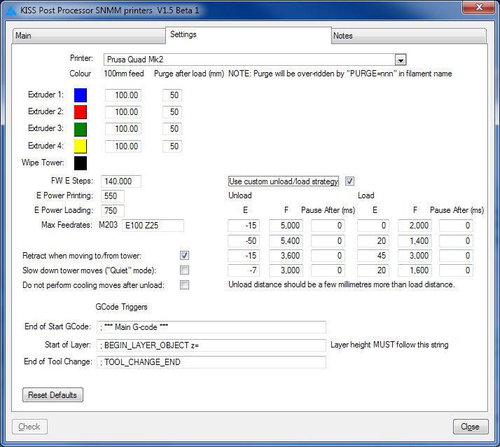

FYI, the post-processor referred to above should now work with extruder types requiring different unload and load strategies, with up to 4 sets of E, F and pause after being user-defined after ticking "Use custom unload/load strategy":
This program is available from the "experimental" folder on my FTP: ftp://PrusaUser:resUasurP@ftp.rumble.si/ . PLEASE DO READ THE READ_ME FILE.
