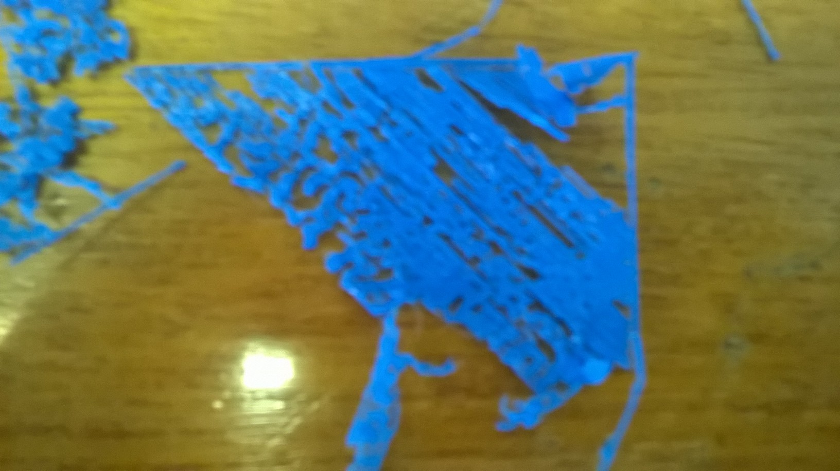

I have been trying to use kisslicer, and Im having a problem like this while printing (image)
I have fixed my extrusion width, the diameter of the filament, and tried to use a higher flow tweak to minimize the problem (I attached a print from kisslicer so you can see)

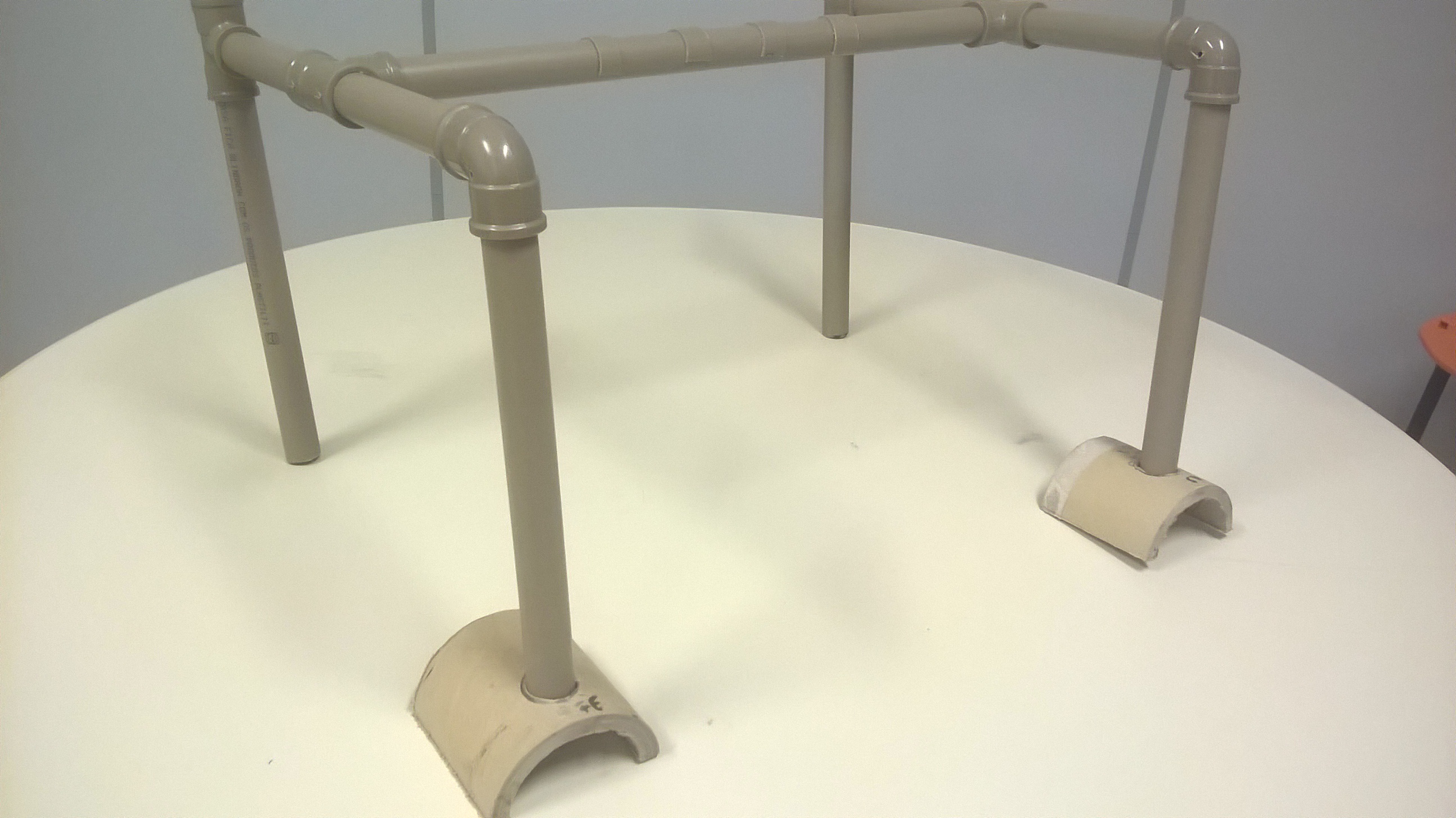

2. I experienced problems feeding the extruders the original way, so I built something for support the spools, and I feed them directly (image) the support stays on top of Cubex, so the filament does the shortest path to the extruders (tomorrow Im going to take picture of the support on Cubex so it will be easier to understand)

When the level is good you have to set the z-Gap, it's good when the first layer is lightly squished on the bed.vallarelli wrote:
Thanks for answering me. Do you use a Cubex too? Because I can try the same way you configure the software, and see if it works.
Im planning to try to adjust the level of the build plate on Monday, if I get better results I will post them here.
Are you using original PLA ?
Into Material tab set the Infill% to 100.
For more consistency, you better increase the extruder's voltage and put a sink on the drive chip.
