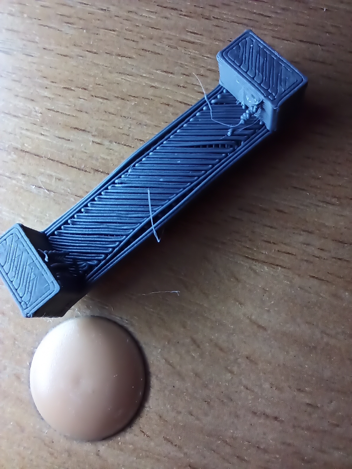

Re: Support for Bridge Settings
Hello,
I tried a little bridge today, yeah, not great results.
I have read about bridges and Kisslicer quite a bit, both here and elsewhere up to 2015. I know about increasing overlap, but it's not like it's a solution. I don't need that overlap across the whole model afterwards, I'm still hoping to fix exactly the situation where you don't need to make a zigzag on the first level of the bridge - there should just be straight lines from support to support.
I don't see any mention of bridges even in the paid version, is there any hope that we will get bridges in the new version?
- Bottom view of the bridgeClick to apply
- IMG_20240829_185924.jpg (571.72 KiB) Viewed 10937 times
