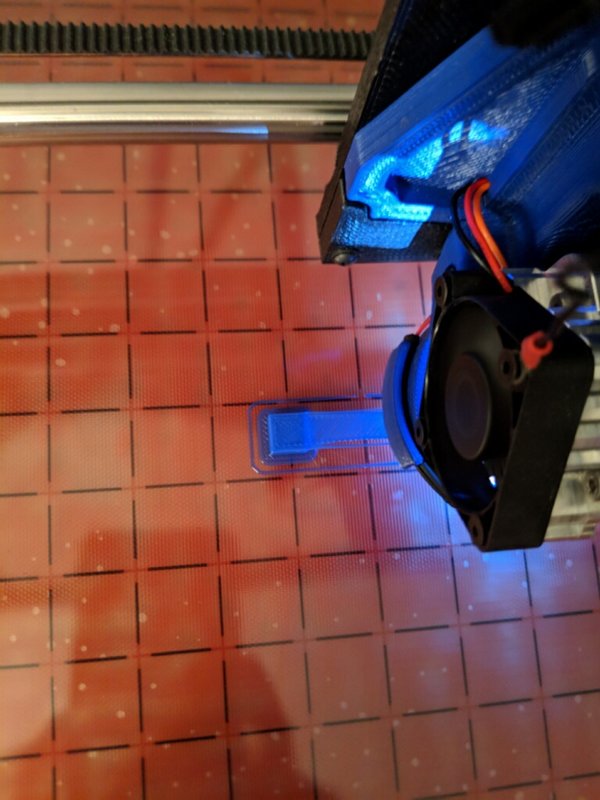

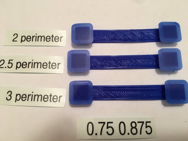

I found I need to have Perimeters = 2.5 or 3, Flow Adjust / Cool = 0.75 and Loop / Solid Infill Overlap =1.25 to get a level surface on the 1st layer of the bridge. It might be hard to see, but here are the undersides of 7 bridges showing the first layers:pjr wrote:Hi Tim
This is partially addressed in the latest 1.6 beta (released today). There is a new parameter (Material/Flow Adjust/Cool) which allows you to specify the maximum volume that the fa can properly cool to prevent sagging. For me, I have this set at 0.75mm^3/s.
I have also increased Printer/Hardware/Loop-Solid infill overlap to 0.85.
Re: Support for Bridge Settings

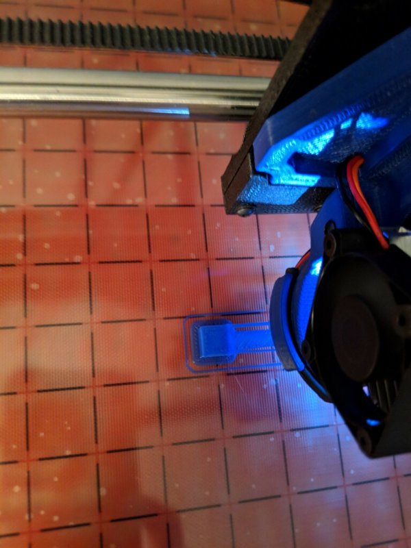

You can see why the first layers turn out so rough looking at the following pics. The bridge infill only touches one side of the bridge perimeters or doesn't touch the bridge perimeters at all:
Here's my best bridge w/ 3 perimeters, Flow Adjust / Cool = 0.75 , Loop / Solid Infill Overlap = 1.25 and only one side of the bridge perimeters is bonded to the infill: Here' my 2nd best bridge w/ 3 perimeters, Flow Adjust / Cool= 0.75 , Loop / Solid Infill Overlap = 1.25 and neither bridge perimeter is bonded to the infill: Here's my worst bridge w/ 2.5 perimeters, Flow Adjust / Cool = 0.75 , Loop / Solid Infill Overlap = 0.1: Please ask Jonathan to fix bridging so the infill bonds w/ the perimeters and of course beef up the bridging capabilities overall.

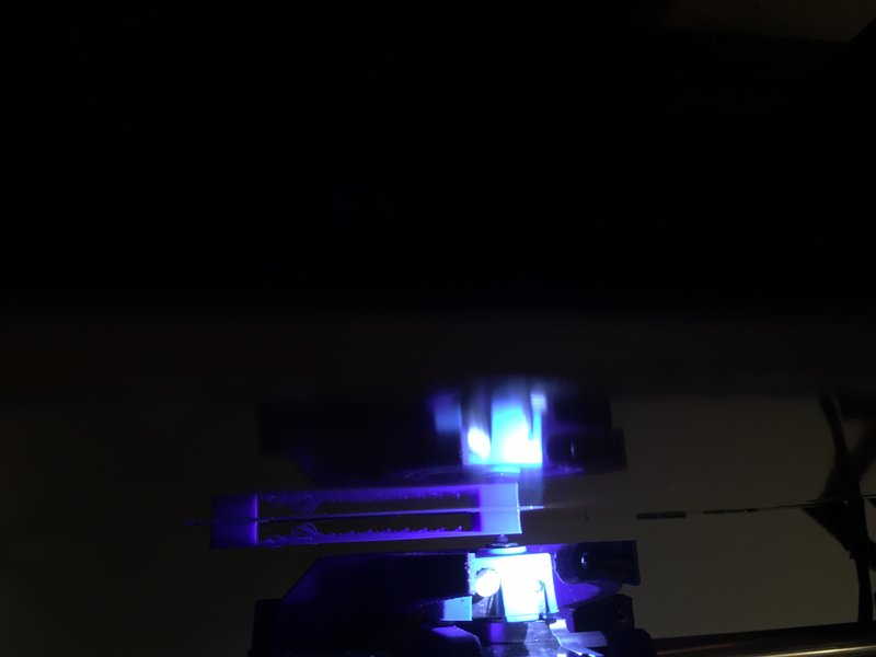

Hello Peter, here's pics of a bridging print using your settings of Material/Flow Adjust/Cool = 0.75mm^3/s and Printer/Hardware/Loop-Solid infill overlap to 0.85. Notice the bridge's first layer infill fails to touch one side of the perimeters: Here's a pic from the side of the bridge where you can see the jaggedness of the unsupported infill hanging down below the bridge: Here's the stl that I used: https://www.thingiverse.com/thing:169049pjr wrote:Hi Tim
Are you able to print this w/ no problem? Does the bridge's 1st layer infill touch both sides of the bridge's perimeters when you print it with your KISSlicer settings?

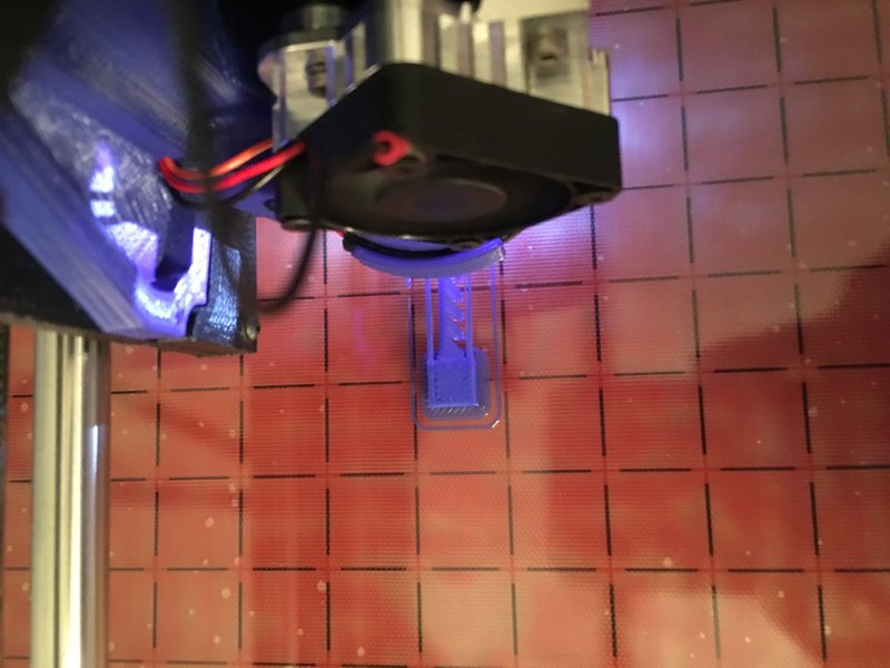

Here's the result:
Overlap values of 1.5, 1.7 and 2.0, but with a cool setting of 2.0 mm^3
I think 1.7 is the better one, but with this test, it does tend to pull in the perimeters; it would probably be worse if the infill were perpendicular to perimeters, but if the infill was parallel to the perimeters, it would probably be perfect
