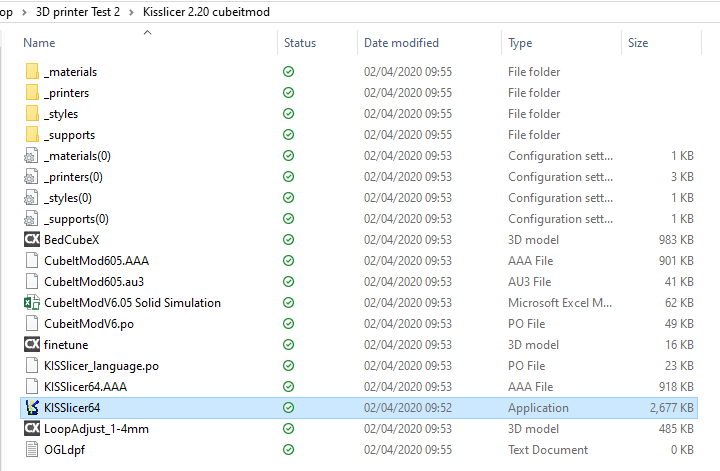

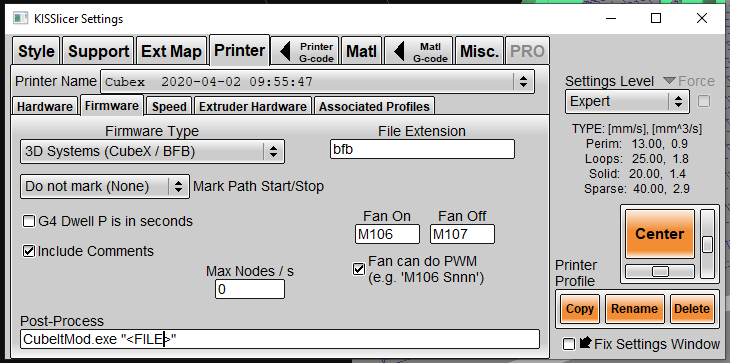

I have tried renaming the post-process. Am I missing something simple. Sorry to be pain but new time user
Capture 3.PNG (34.46 KiB) Viewed 10631 times
Capture 1.PNG (6.19 KiB) Viewed 10631 times

Thanks for . Can you look at the photos above and see if there is any obvious errors? Thank again

i see the Problem there is no cubeitmod.exe in your Kisslicer Folder, sorry but so it can't run
you have to download "download/file.php?id=683" unzip in your Kisslicer Folder and set post-process
Cubitmod605.exe "<FILE>"
