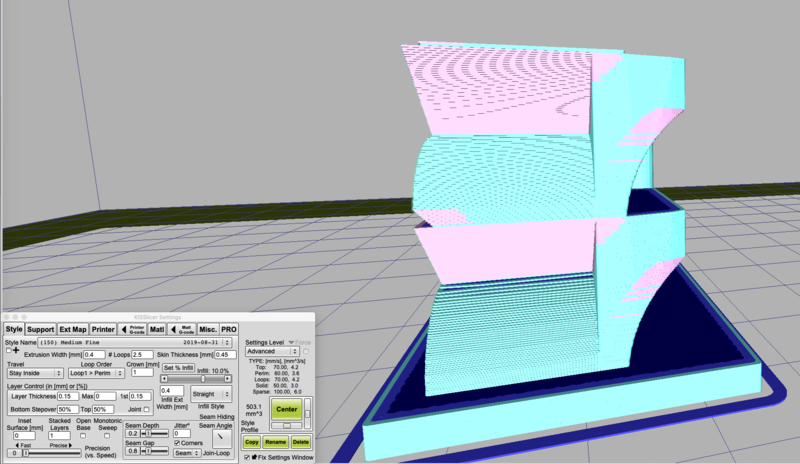

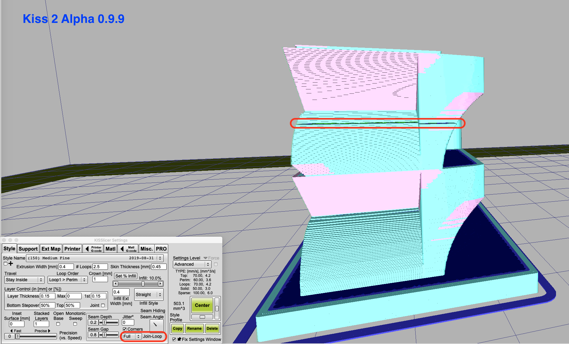

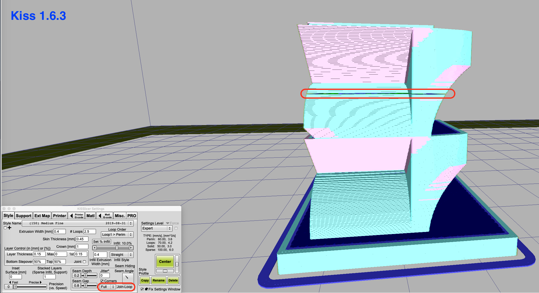

I think I found a bug with a particular model and a specific setting Full Joint-Loop (tab style).
This bug exists in Kiss 1.6.3 and 2 Alpha 0.9.9.
Can somebody try if it can reproduce it.

The pictures :
missing layer kiss 1.6
missing layer kiss 2

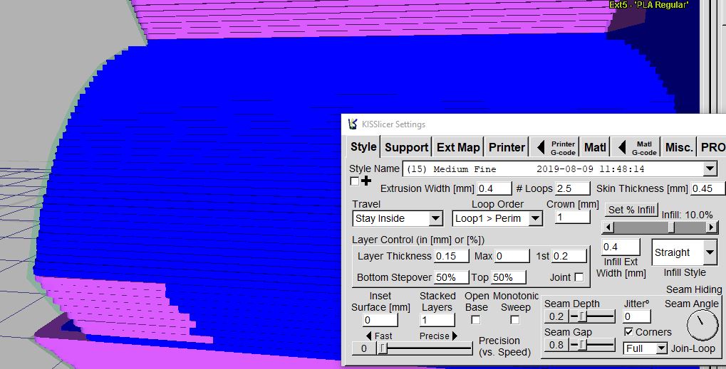

Correct one with Joint-Loop at Seam :
no missing layer
no missing layer

Hum, I don't push further the investigation last time but... after seeing the generate G-Code with Simplify3D it's seems the generate G-code is correct.
Then it's probably "only" a preview bug, that make it totally less critical.
