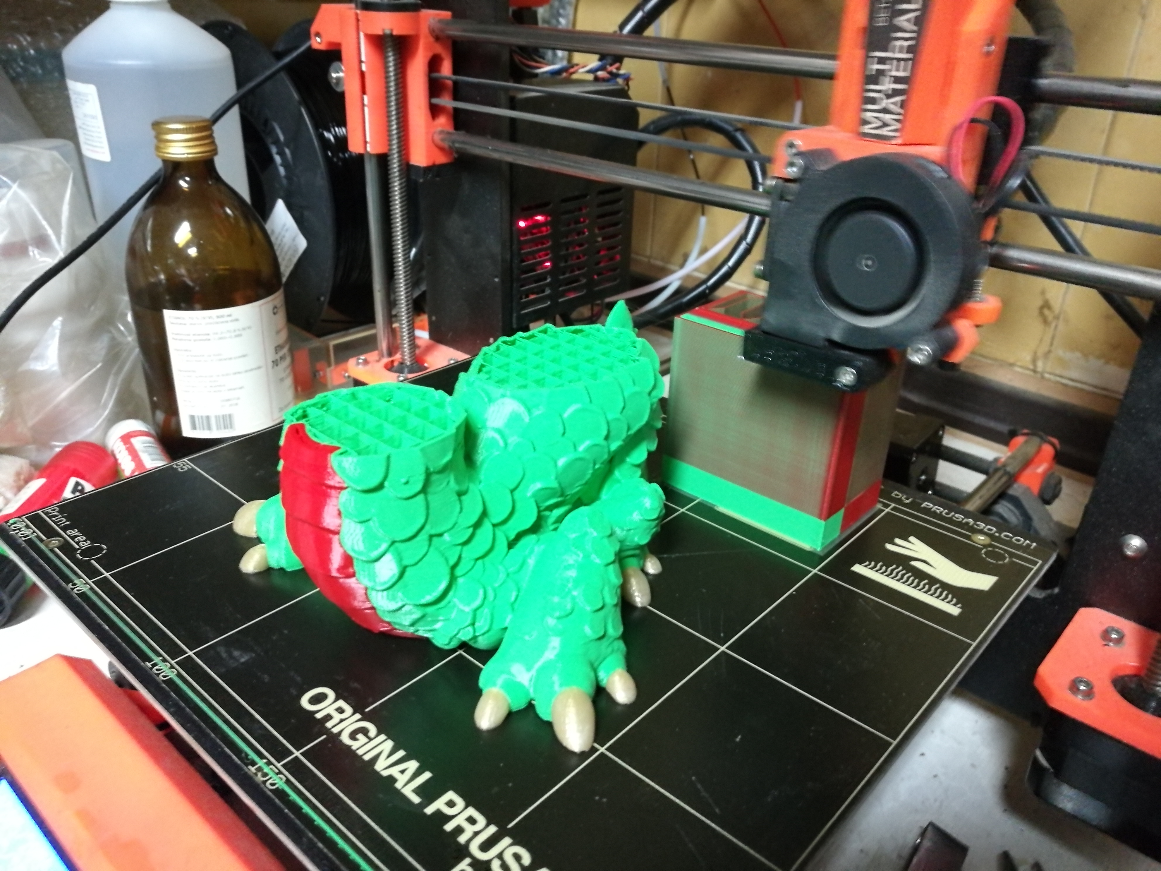

First a picture of the Prusa with quad upgrade and the wipe tower during a print:
Note the single nozzle arrangement with filament multiplexer above the extruder. The motors are sitting on top of the frame.
With the Prusa method, there are 2 downsides; the time taken to change filaments and the filament waste. I did a 4C print of Adalinda; the wipe tower weighed 6 times more than the model.
Let me have a look at the Cyclops and how it works; I will then see if I can amend the PP to work with it and to meet your requirements.

...by the way what is the name of the print you're making in the picture? It looks interesting.
