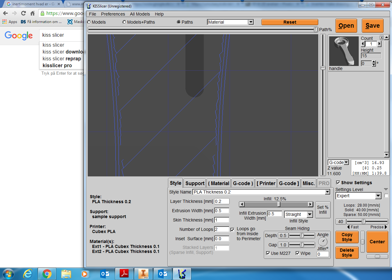

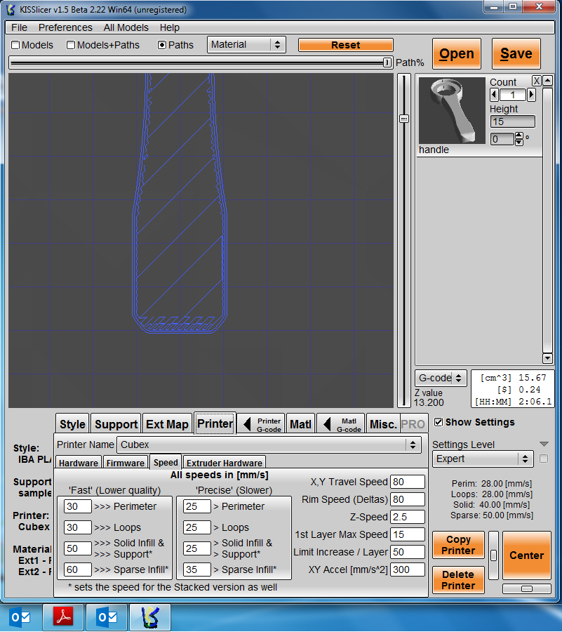

Hey everyone
I'm new to the KissSlicer, and have recently got a CubeX Duo.
When slicing, its creates a funny extruder path.. See attached photo...
Is there a good explenation or a way to get it straighten out?

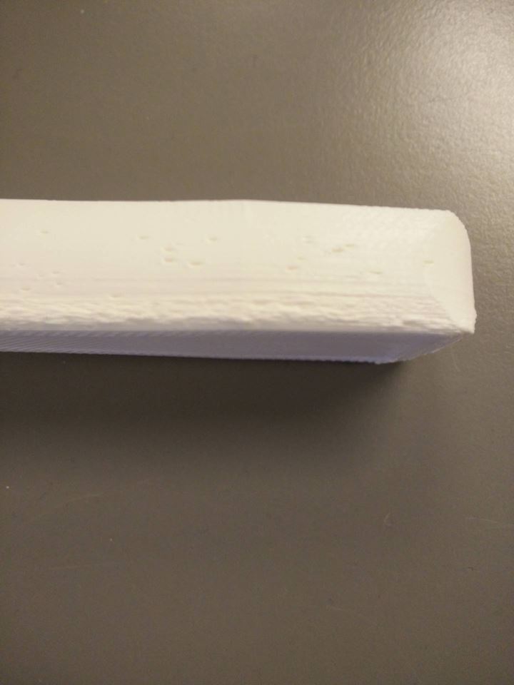

I also having problem with small "hols" along the sides without material.. small blob... se picture.

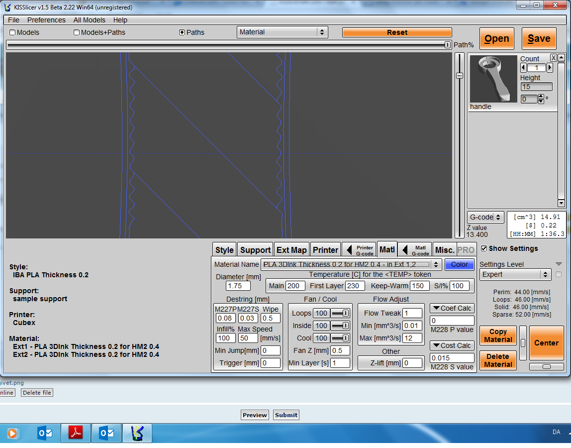

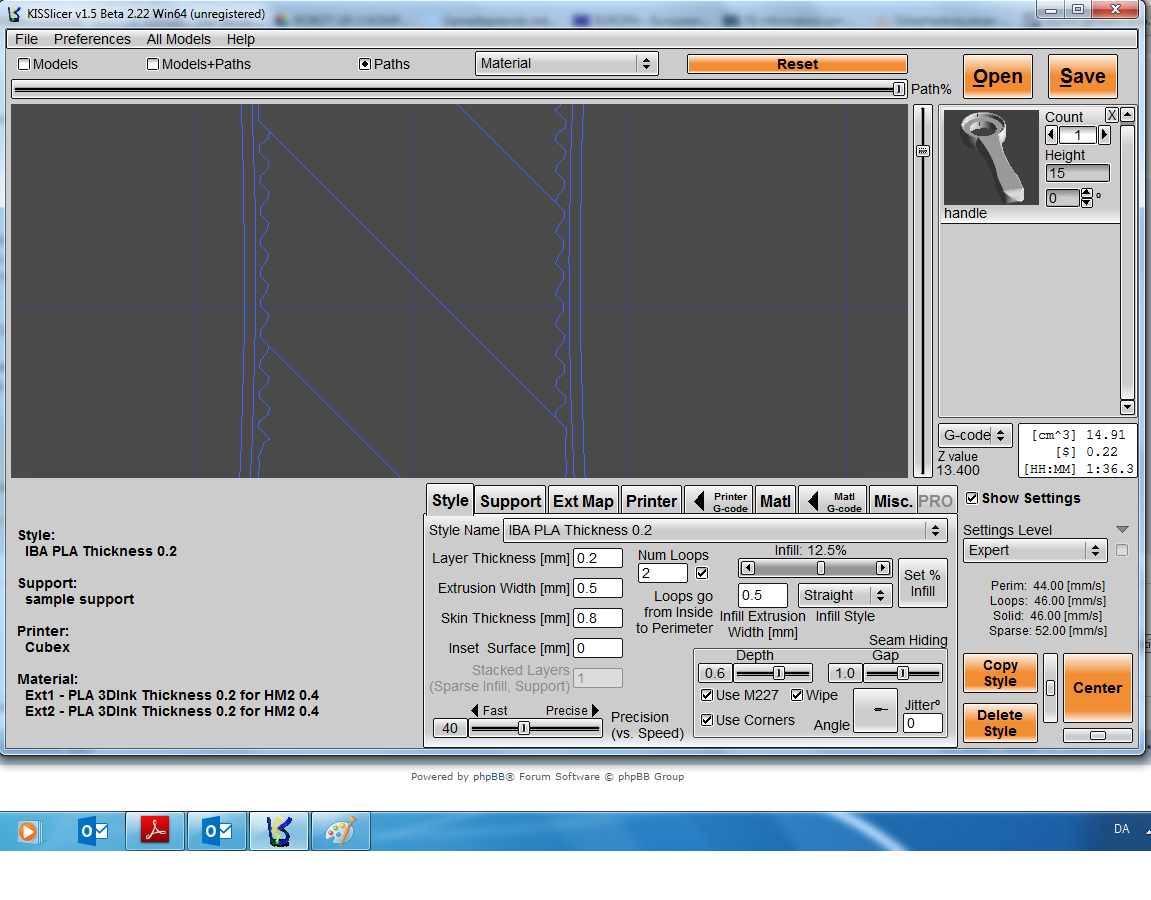

I have know done the slicing in the new 1.5 beta 2.22 version.
I still get thiese wierd zig-zag lines.
If i print with thiese, it gets all bumpy and rough...

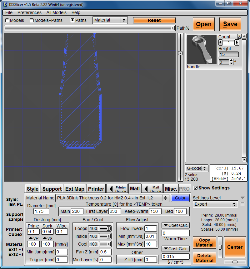

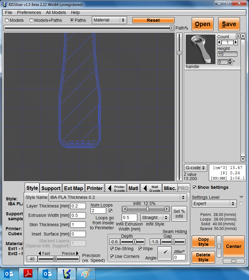

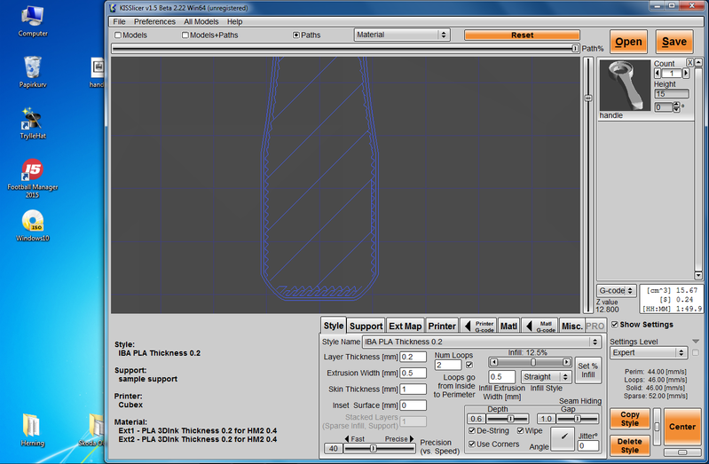

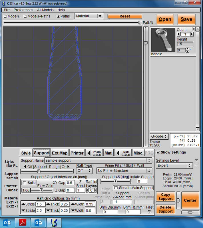

I have added the settings from the style, material, support and printer tap... Hopes that it.. and the .stl

- Posts: 241
- Joined: 18 Nov 2014, 09:34
Re: CubeX path problems
The skin is the surface produced with "Solid" and not with Perimeter+Loops.
If you have a 0.5 noozle with 2 loops and skin 0.8 mm , you still have lateral walls of 1mm (2x0.5) but superior and inferior surfaces are made with 4 layers of 0.2 = 0.8 mm.
If all the surfaces are perpendicular to each other there are no problems setting Noozle x Loops = skin , but in a model like yours you better set a thinner skin or Kisslicer will produce small zig zags to increase the thickness of the skin.
You better install the language file Cbeitmodv6.po, that way we can "speek the same language" for settings.
The small holes are probably produced by wrong M227/M228 settings or by a PLA exposed to humidity. Try to reduce a little the M227P now you have 0.1 try 0.08 or 0.06.
The blobs may be produced by wrong calibration. Didi you run a cylinder calibration to set your initial parameters ?

Hi again
I tried to change the skin thickness to 0.8mm. It didnt change the outcom, se picture...
i also tweaked the M227P to 0.08
I also loaded the language file again...
