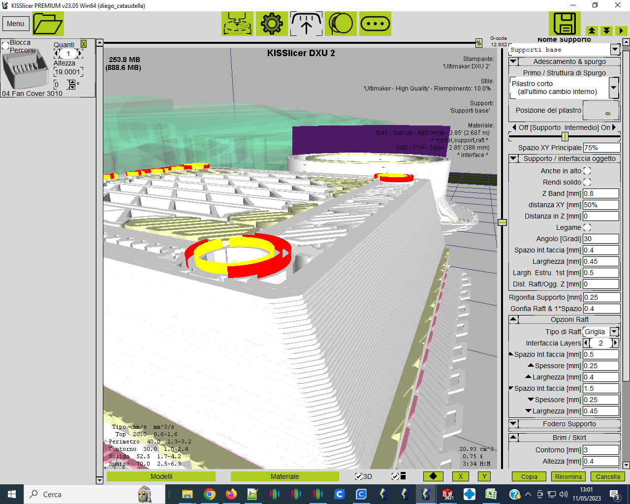

i sliced it and there are these red and yellow lines that are not flat but they look thin and tall what does that mean?

Re: Double extruder temperature regulation
The red/yellow curves denote where KISS has found arcs and generated G2/G3 G-codes
