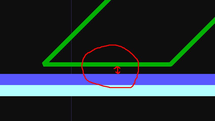

It is very necessary to adjust "Loop / Solid Infill Overlap" separately for solid and sparce infil.
Current versions have too much space between sparse infill and loops. It is more than space between solid infill and loops, and should be the other way around.
A separate adjust will solve all the problems.
Also, the space between the sparse infill and loops does not depend on the width of the extrusion for sparse infill, which is not correct. Need to fix.
Thank you in advance.

Thanks. Will pass on your comments.
EDIT: On the "ToDo" list to look at. It will not be included in 23.05, but maybe a later release.

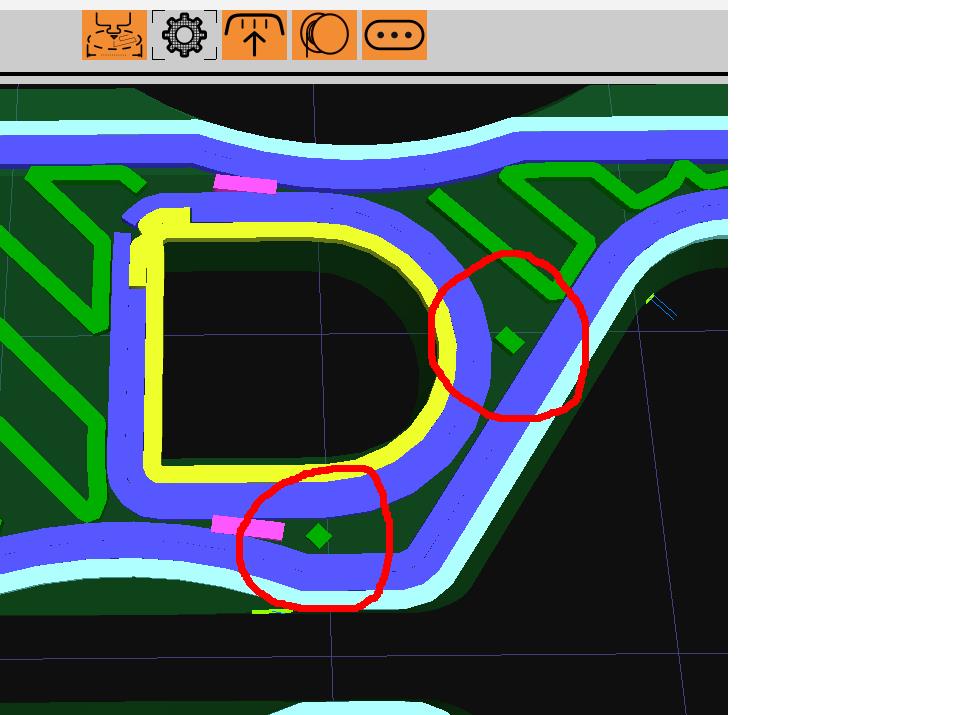

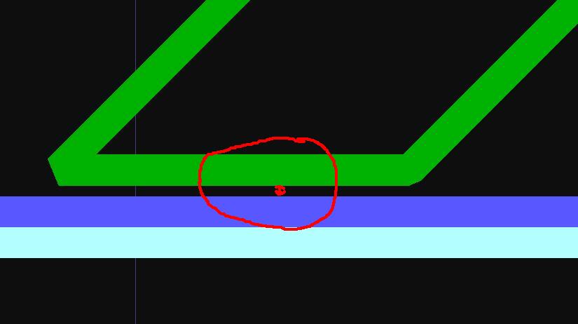

Peter, I want to add some pictures about Loop / Solid Infill Overlap? beacause it problem very imorted.
This is slicing with Loop / Solid Infill Overlap=0. The first picture is a solid infill - everything is fine. The second picture is a sparce infill - it does not reach the loop.
If i increase Loop / Solid Infill Overlap so that the sparce infill reaches the loop, then the solid infill will overlap the loop too much.

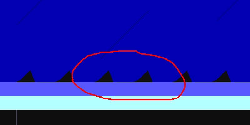

Also, if we reduce the width of the extrusion for sparce infill, then we see in picture 3 that the gap has become even larger.

OK, thanks. Will pass this on as well
