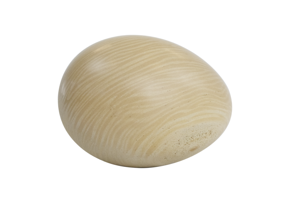

maybe i can explain it better with a photo:
This is what i would like to get.

you hear wrong in kisslicer is possible to make a surface texture thats looks like wood ringing.
to get ringing in Wood filament is a temperture setting higher gets darker prints (rings) but choatig isn't possible
