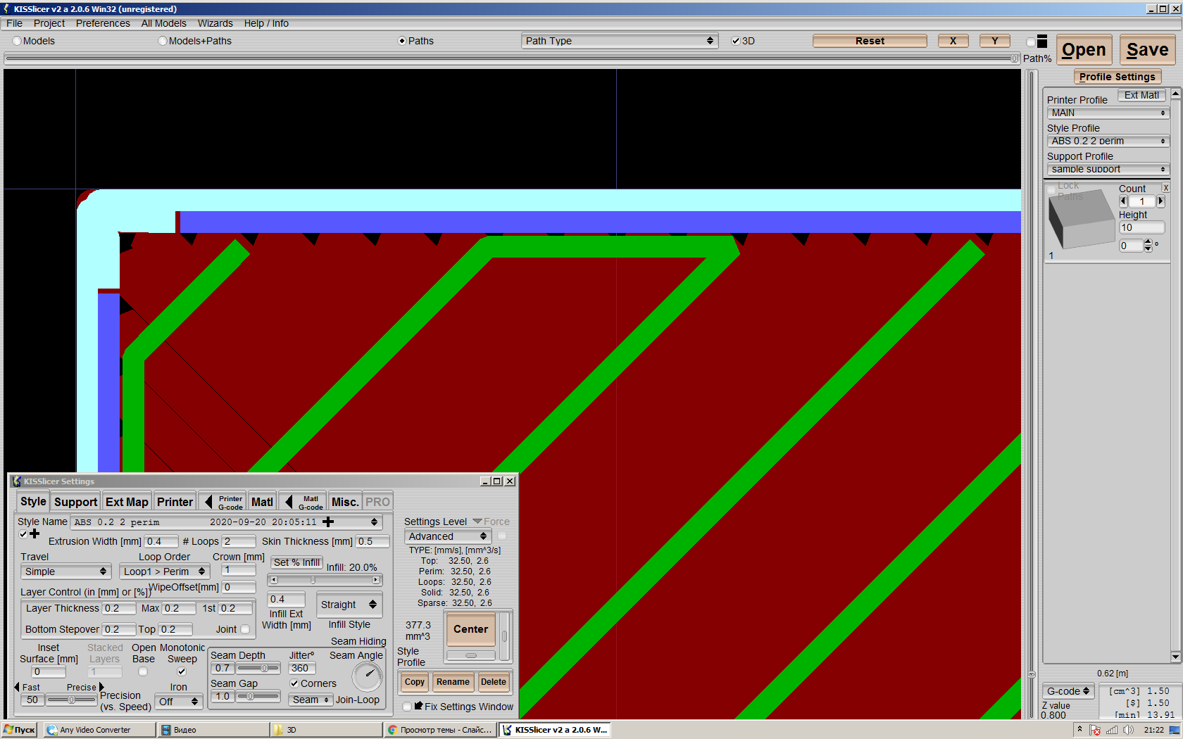

If infill not 100% and Loop/Solid Infill < 1 infill does not touch the walls. This happens after version 0.0.4
At the picture you can see that with Loop/Solid Infill = 0.5 and infill=20%, the Infill does not touch the walls. Only when infill=100%, everything will be fine.
