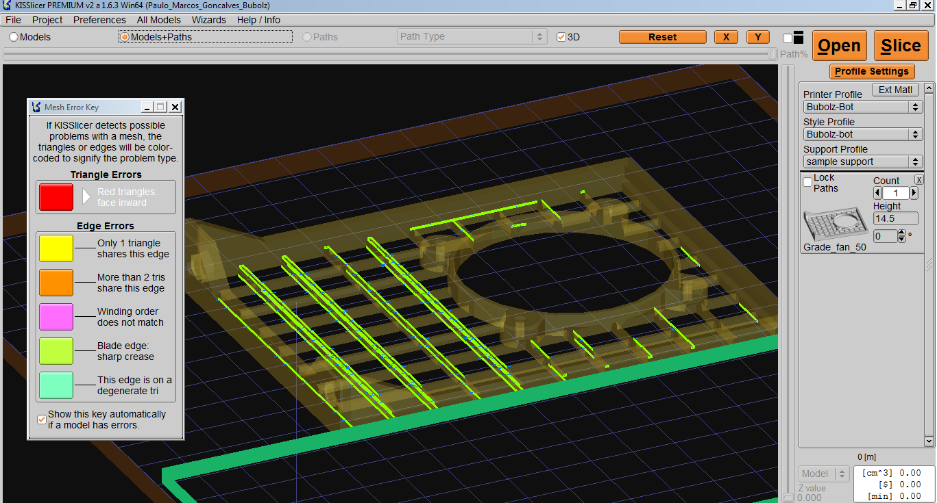

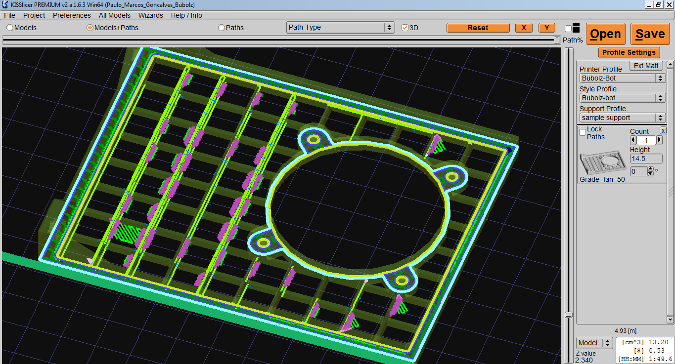

I need to print grids for my projects but whenever I print a grid on Kisslicer I encounter this problem ... the slicer accuses the presence of "Blade Edges". But even so kisslicer "deposits" randomly material on top of grid. This happens with different versions of Kisslicer and with different grid designs that I print.
I attached the sample STL

Bad modelling, 261 overlapping faces. Error checked in 3DS Max.
