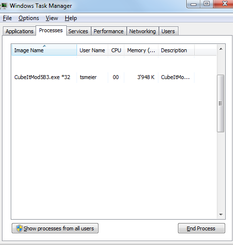

I just tried what PenskeGuy suggested, for me it is working fine to overwrite an existing file without any issues, but this might depend on some Windows settings. Do you get the "Completed" Message at the end of the Process or does it freeze before you get the Message? In case you slice big and complex models it might take quite long before the Message shows up. You have to click OK on the Message before you can use Kisslicer again. If it freezes again check the Processes Tab in Windows Task Manager, you should find CubeitMod there. End this Process should be enough to recover from a frozen system.

The both freeze , I can close KissLicer but no the CMD-window, With TaskManager in application I saw CMD but no respond, I don't can stop it and no saw CubeitMOd* in tab-processes,
