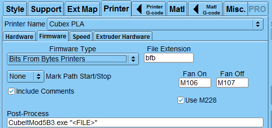

Hi Yves
Please post the .stl file you sliced and the .bfb and .bfb.bak files that have been created with Kisslicer/Cubeitmod.

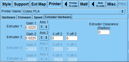

Is your Kisslicer set up like this:
Firmwaretype is Bits from Bytes Printers, the correct CubeitMod file needs to be selected as Postprocessor on the Firmware Tab, Include Comments and Use M228 selected
Gain Values 0.0225 on Extruder Hardware Tab

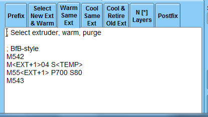

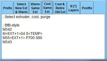

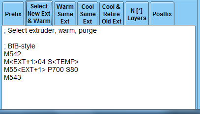

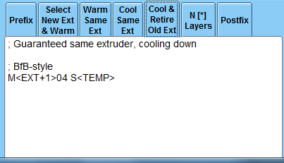

Check all G-Code Tabs to look as follows:
^Firmware:V1.07
; [mm] mode
G21
; absolute mode
G90
; Select extruder, warm, purge
; BfB-style
M542
M<EXT+1>04 S<TEMP>
M55<EXT+1> P700 S80
M543
; BfB-style
M542
M<EXT+1>04 S<TEMP>
M55<EXT+1> P700 S80
M543
; Select extruder, cool, purge
; BfB-style
M542
M<EXT+1>04 S<TEMP>
M55<EXT+1> P700 S80
M543
; Guaranteed same extruder, cooling down
; BfB-style
M<EXT+1>04 S<TEMP>
M103
M104 S0
M204 S0
M304 S0
If not, change the settings and try again.

yvessavard053
Posts: 15
Joined: 02 Apr 2015, 12:46
Re: G-Code for CubexDuo With KL beta2.2 and UniversalCmod
Post by yvessavard053 »
Hi Tobi !! :mrgreen:
I have followed yours instructions !!

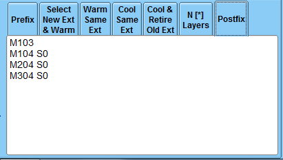

Changed for Bits for Bytes printers
Cubeltmon5B3
AND FOR POSTFIX M103
M104 S0
M204 S0
M304 S0
and now I'm happy with your help
My CubexDuo work very well...only I need now making good finetuning for printing
Thanks a lot for your help....I'm leaving crazy times for enjoy timessss !!! :D
Yves

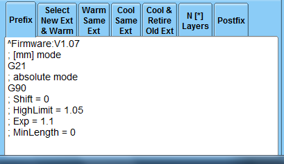

If you are using CubeitMod5B3 you need to set the Prefix Tab correctly. Exactly as shown here:
Copy and Paste this:
^Firmware:V1.07
; [mm] mode
G21
; absolute mode
G90
; Shift = 0
; HighLimit = 1.05
; Exp = 1.1
; MinLength = 0
Regards,
Tobi

Hi Tobi..
Yes I was have this in* print gcode-prefix *
Thanks again
