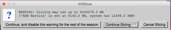

I had the same problem. I even run the Apple Hardware Test and, to my surprise, I found a failure somewhere in the memory, like Error 4MEM/9/40000000:0x877cc118, and so on. Then I run the Rember, and also got some memory problems. Well, I was decided to change my memory cards (I have on my iMac 12Gb RAM), but I decided to click on Preferences>File Handling>Preview on Open STL, since the check mark was not there. To my surprise, even clicking there, the check mark does not shows up, but now the main screen shows the models with no problem whatsoever, albeit in some of them I get a weird message, like WARNING: Slicing may use up to 6242078.5 MG ('RAM Warning"is set at 6144.0 MB, system has 12288.0 RAM) . Well, I guess this is just impossible, since the model is not that big. I have to investigate what is going on. However, the main problem was solved. Please try this and let us know.
KISSlicer message 1.png (29.51 KiB) Viewed 4060 times
