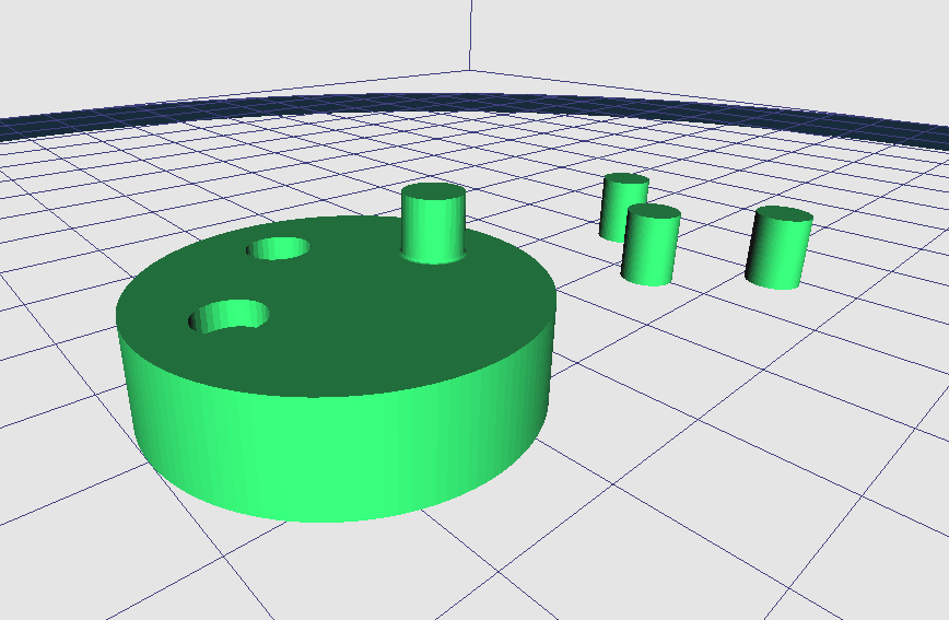

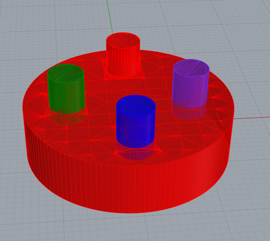

Jonathan, the new feature "Stack Vertically" is *almost* what I need! I've been experimenting (with manually splicing gcode) with stacking 2 or more STLS to create internal structure in parts to impart strength, or for aesthetic reasons. For example, here is the design in Rhino (converted to meshes). The red part is one object. I save it as an STL file. I then select the blue, purple and green posts and save all 3 of them as an STL file - they maintain their position (i.e. they are at Z=3 ABOVE the print bed).
When load these in KISS, I get:
Screen Shot 2015-02-28 at 9.34.51 AM.png (54.07 KiB) Viewed 2728 times
I was hoping to have the parts maintained in their original coordinates. This would be a great option and would allow printing some very interesting things that I mentioned in the email I sent a few weeks ago.

If you select your multiple .stl files, and drag and drop them into KS, they will have the orientation you are wanting. You can also select multiple .stl files using OPEN.
Using OPEN and separately loading each stl ignores original coordinates

You made my day! Thanks. I had tried multi select open but since I am on a mac the standard way of doing it doesn't work. I just tried a few keys and discovered Ctrl-select does work and does exactly what I want on load! Thank you!
