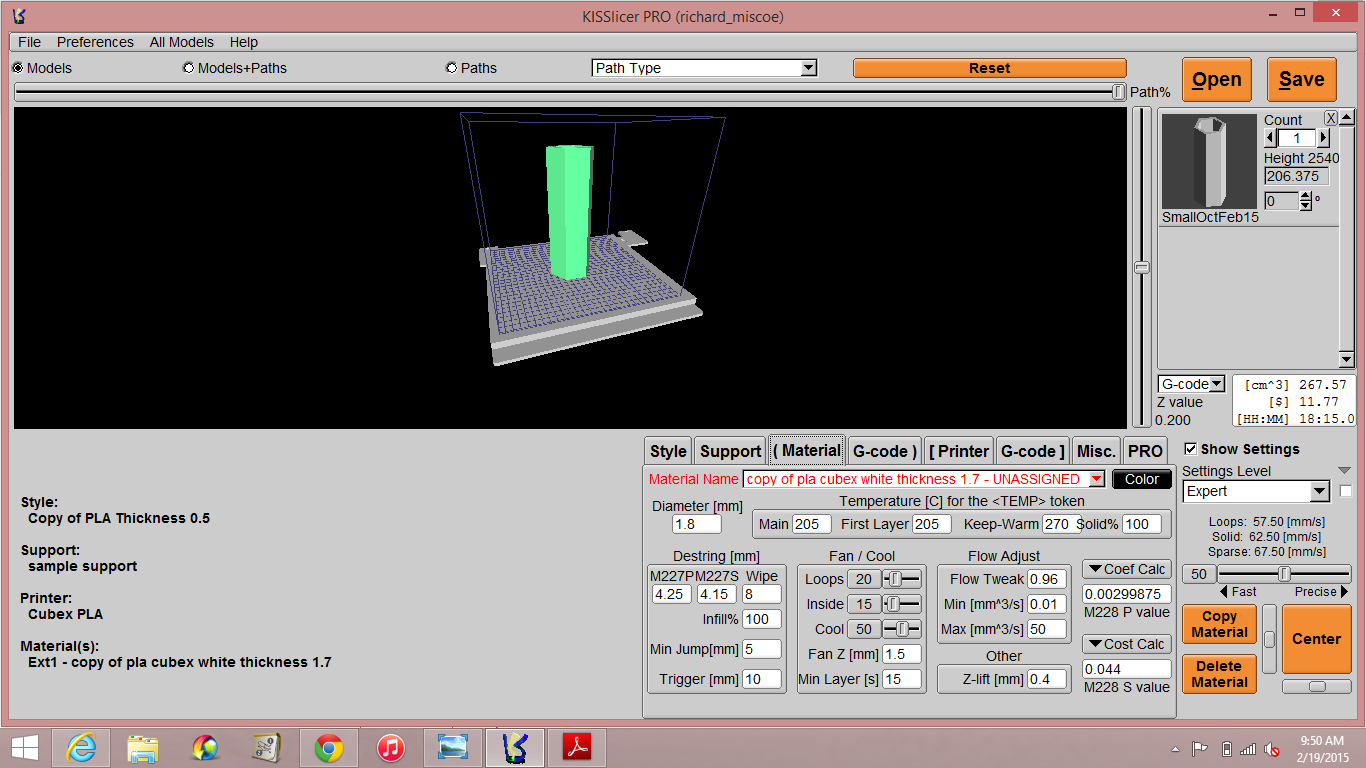

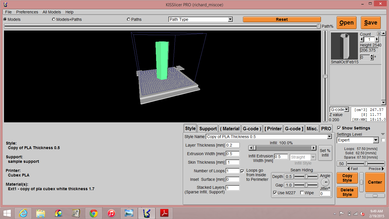

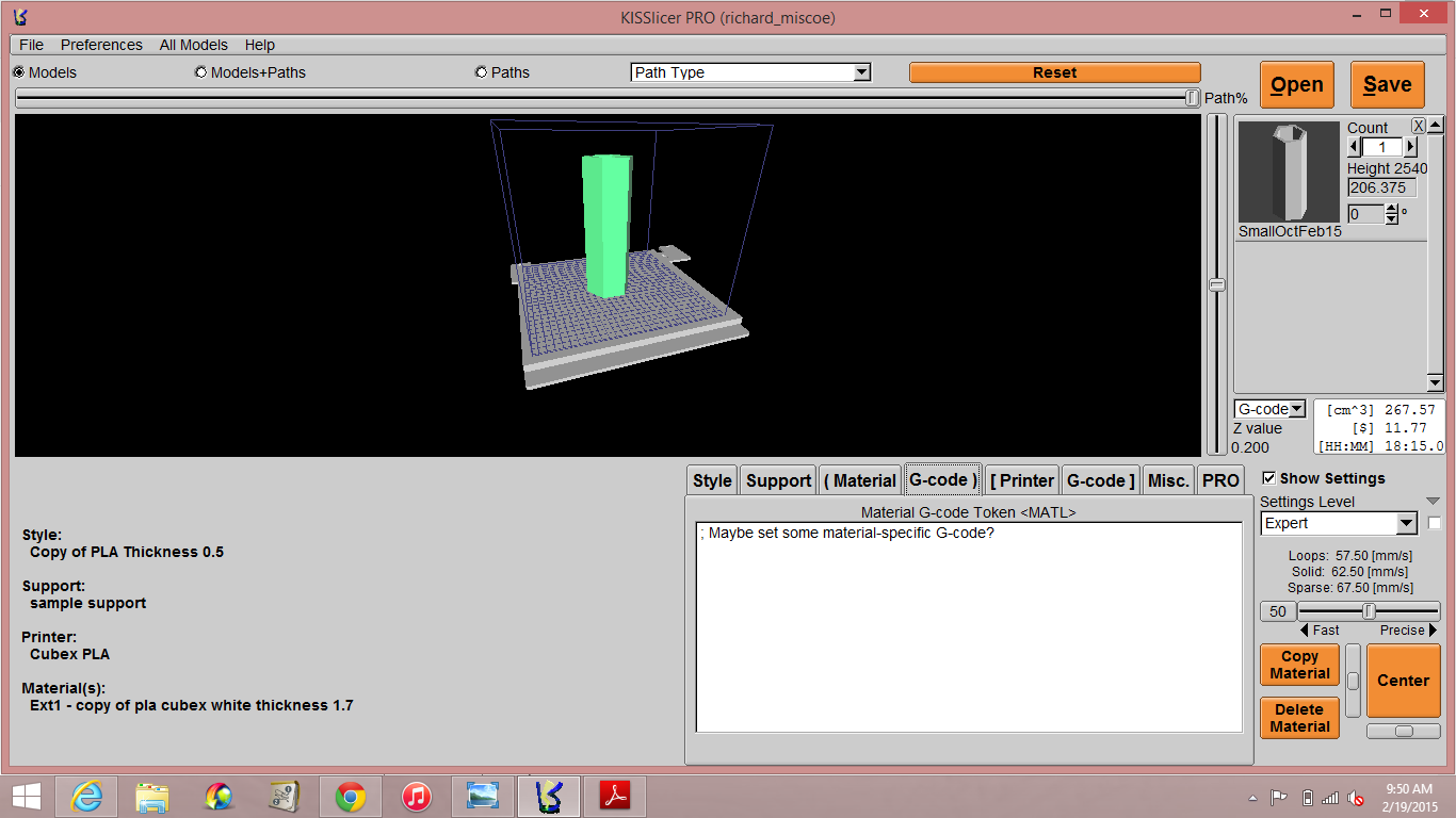

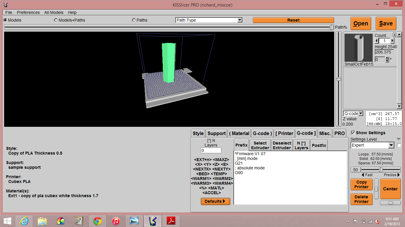

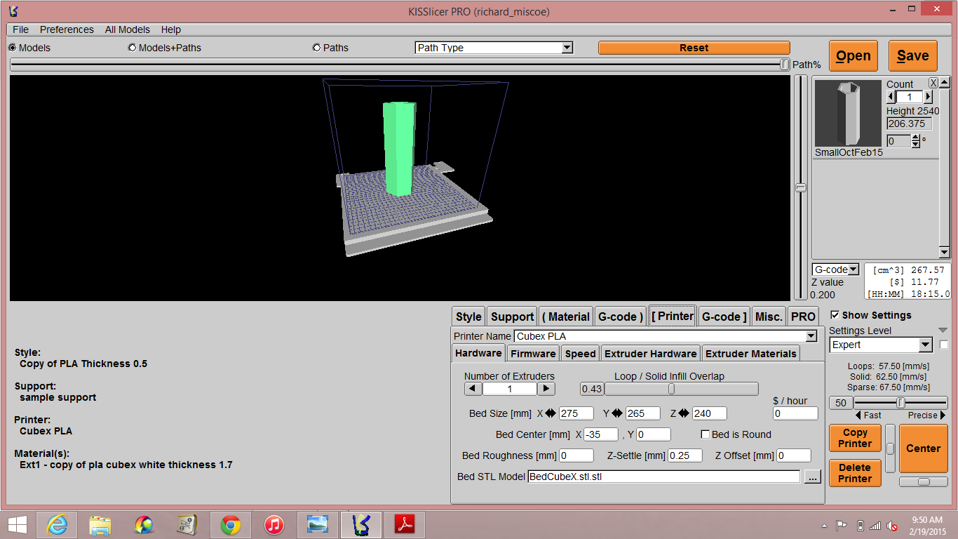

I am running Windows 8 and have a CubeX with one extruder. After trying to adjust my Kiss software as per the new User Manual dated 1/2/15 , I am just getting a big glob on my new print tip, both with ABS and PLA. Could you please look at these screenshots and let me know what I am doing long. Felt I needed to write you guys a book called Kisslinger for Dummies as I have made about every mistake a guy can make. Your help would be so much appreciated!

First you put really high value in material tab for m227 p and s. It's more like 0.04.
