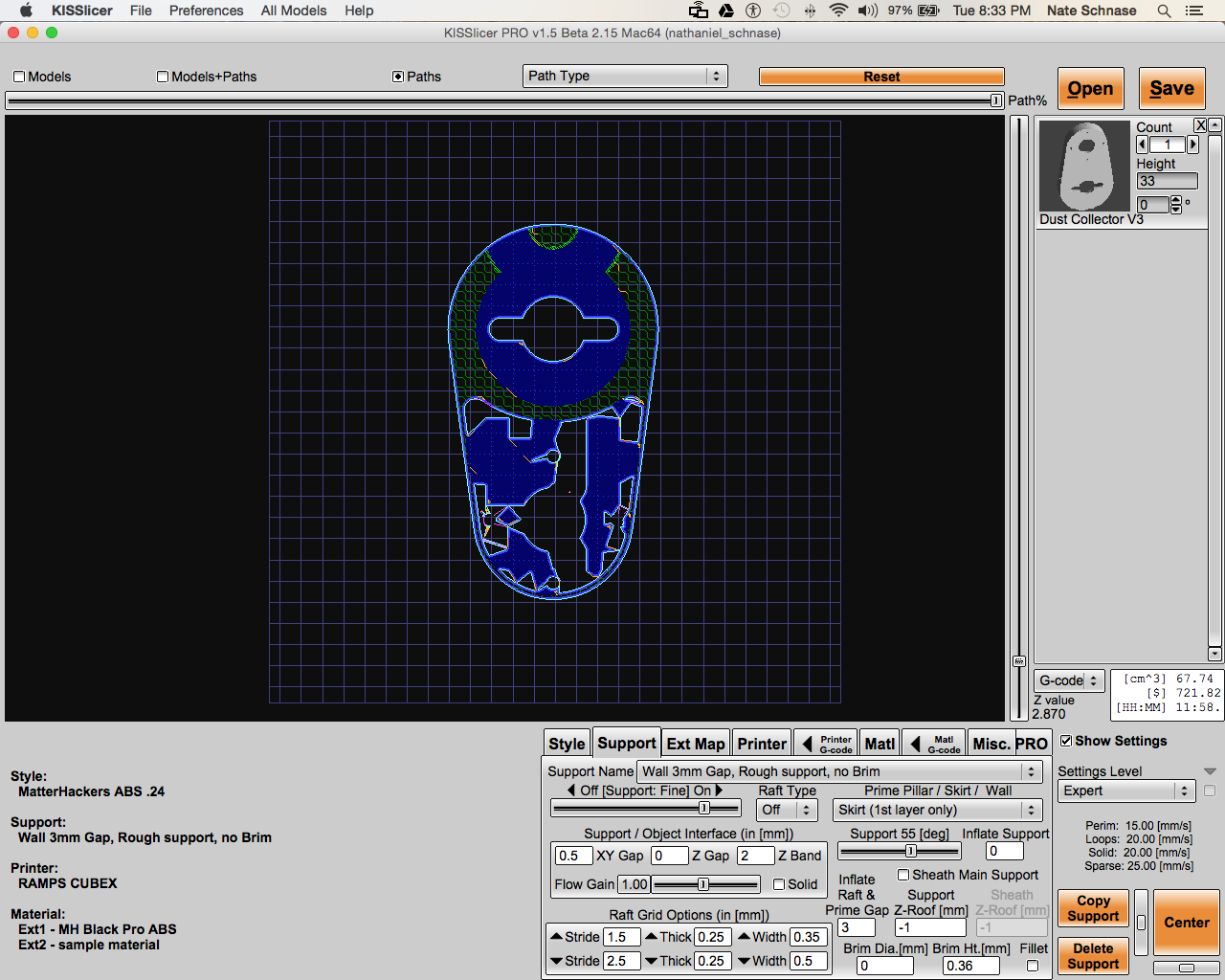

Getting an abnormal slice on this STL. Appears to be a bug. Getting strange layer on at 2.870
Mac Bug Beta 2.15

Re: Mac Bug Beta 2.15
Wow! A bug report on a build *before* I announced that build was out! This is a new record for me! [8^)
Does it look exactly the same if you quit KISSlicer, reload and try again?
I can't see it on Win64, but I also don't know what settings were used. Could you please zip up the setting files and attach the zip here?
I will not have time to look at this tonight, but I can work on it tomorrow.
Hi Lonesock,
Sorry about that!
Here's the INI files I'm using.
I don't see the issue on my windows 64 machine either.
PS. To any admin - I tried to delete and move this to the bug section, so there is a duplicate there. Apparently I have special needs when it comes to not posting in multiple areas...Sorry
Sorry about that!
- INI_Files.zip
- INI Files
- (3.59 KiB) Downloaded 557 times
Quick question: does the problem disappear if you change the slice thickness a tiny bit (like from 0.2 to 0.201)?
