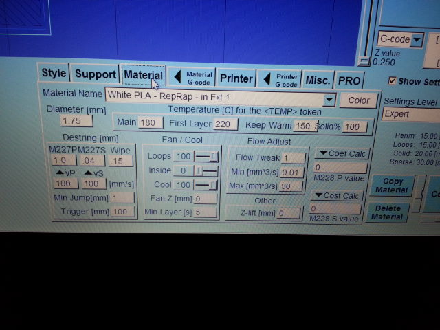

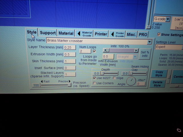

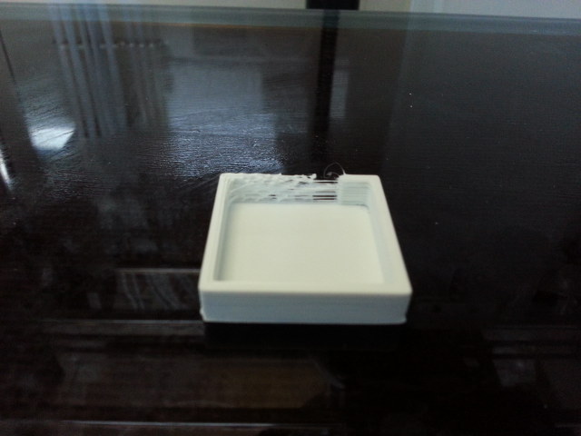

I have printed 15 of these boxes today with every different setting that I can think of and cant get rid of this gap on the back wall. What am I missing???? It prints fine with older versions.
Re: Need help with new version

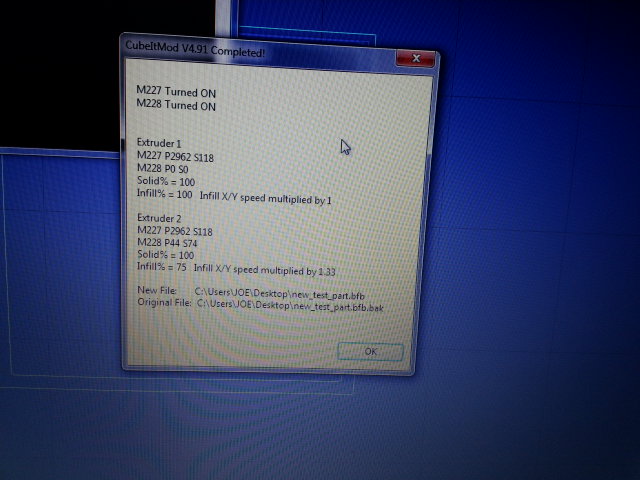

It looks from the settings' "translations" that you are maybe using the CubeItMod post-processor? If so, maybe post those settings as well?

Yes, I am running Cubitmod. are these the settings that you are referring to?

Hi Joe,
It's better to use the previous beta version of kisslicer for now. Giovanni is really busy now and cannot do the code modification to match with the new PS function.
