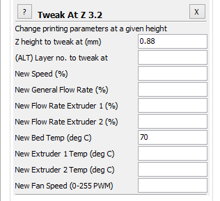

Cura has a plugin that allows settings changes based on the layer number or height of the build (see pic). This has come in handy sometimes so I would like to see something like this implemented in KISSlicer and I would like to see the % infill included w/ this option.
Specify Settings Layer By Layer

Any post processor is a patch/workaround for a missing feature/bug of the main program, and could be included in the main slicer.
Meanwhile, back at the feature request : If one looks at the posts in this topic area, there are several that want something spcial at the first layer, last layer or somewhere. Temperature mostly but something else, too. So a "general" way to specify changes for a few specified is the natural solution. A partial solution is already in the program with the "every N" tab. This just needs to be extended (easy for me to write, I know) to which layernumber it is invoked on. (Messy in the UI, another sublayer of tabs or whatnot). Our great developer has to decide if just doing a "text include" of a M104 S<temp> as now, or to actually have something the influences the slicer algorithms - number of perimeter loops, or skin thickness f.ex - is the way.
So it is not a question of duplicating the cura design, but to enable us to solve a slicing problem : To paraphrase it -"One size" does not fit the whole model
