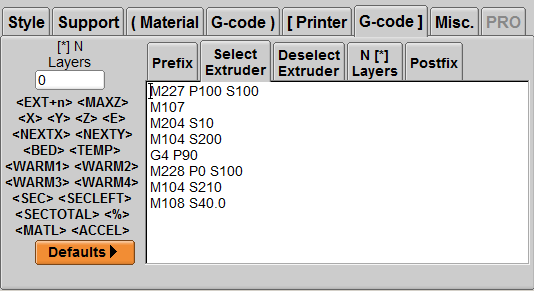

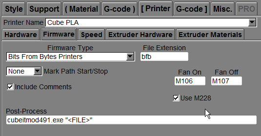

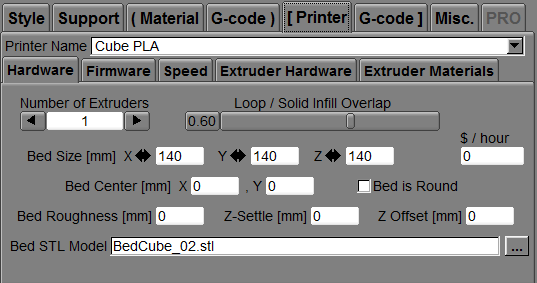

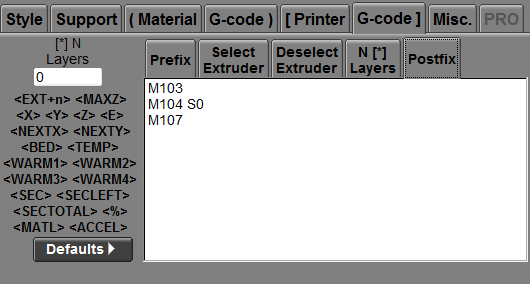

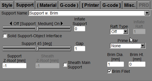

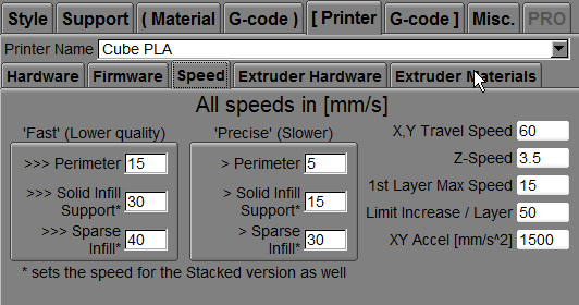

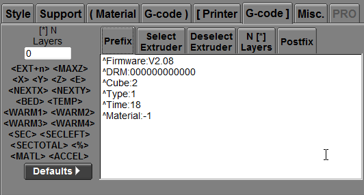

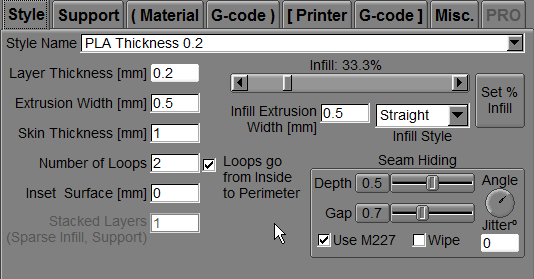

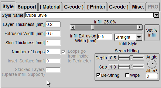

I have a Cube 2 2nd Generation firmware 2.08 and have been successfully been slicing with KISSlicer. I have done setups both with and without Cubeitmod. I use Codex to Convert to to .cubepro and then renaming it to .cube
I use Dan's Crap hack Bulk filament technique (removing cartridge mid print) from cube3d.createaforum.
I prefer to use cubeitmod and then tweak it for the cube 2 2nd. Gen. Only issues lately are some stringing but probably printing with lower temps or enabling wipe function would remedy that also.
Let me know if you have any suggestions for improvement.
See KISSlicers settings below.
Bob

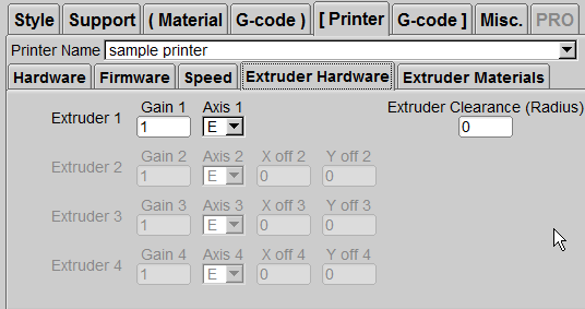

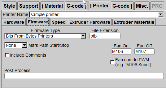

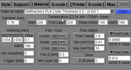

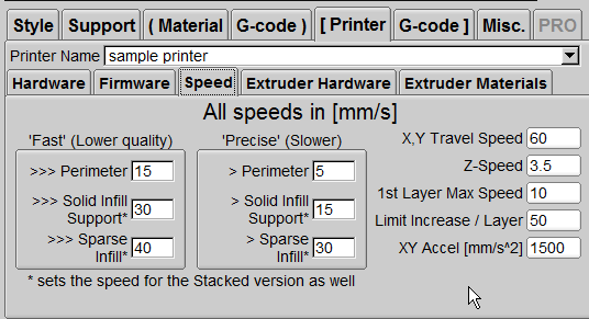

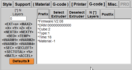

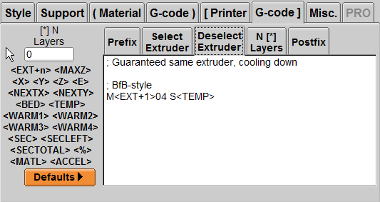

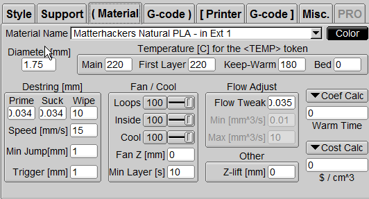

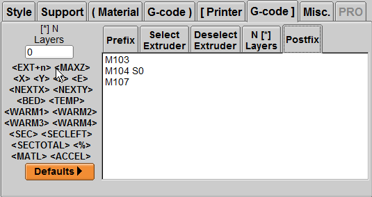

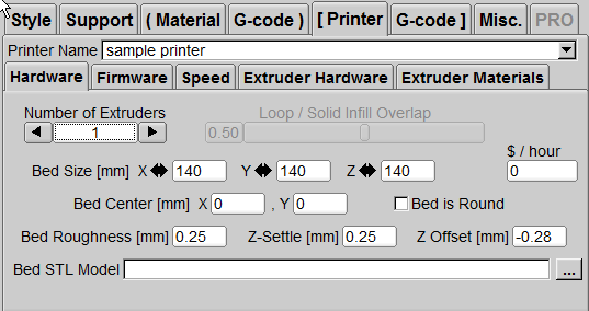

This is my other approach, setting up KISSlicer (Cube 2 2nd Gen. firmware 2.08) without using Cubeitmod.
When the .bfb file is exported I just Encode it with CodeX for CubePro and when finished, just rename the .cubepro to .cube
Make sure you keep the flow adjust very low around 0.035 (other workaround is to change the extruder gain to 0.035 and then flow adjust will become 1 )
Also make sure the z-offset is set to to -0.25 - -0.28 to get a nice squished first layer.
Also make sure comments are disabled in Firmware settings, so the g-code first line will remain ^Firmware:V2.08. Otherwise the Cube 2 won't print it...
With this setup I get better small details then with the CubeitMod, but the first layer (only the first is over extruding and I get molten polymer waves)
Let me know if anybody has some ideas for better tweaking.
