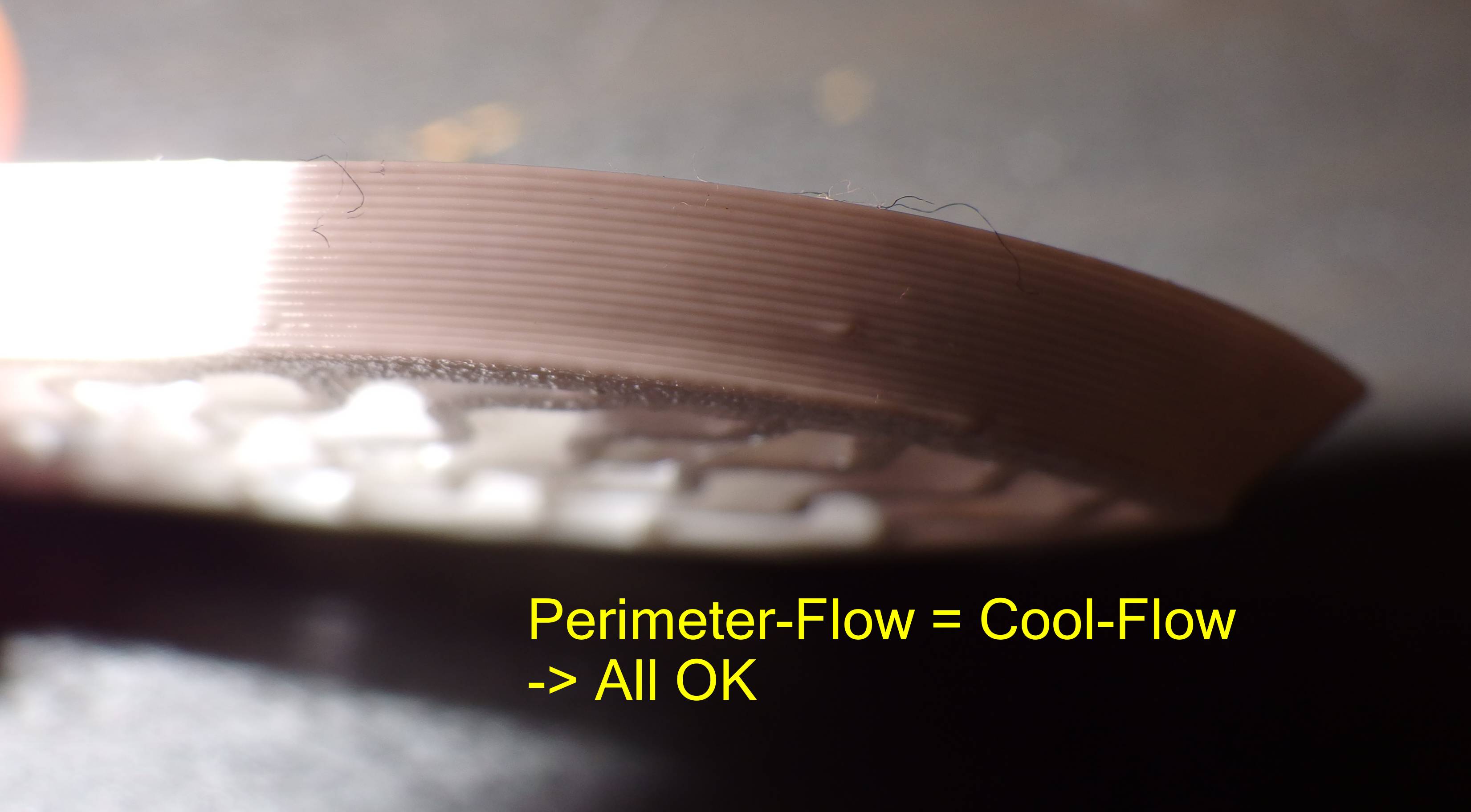

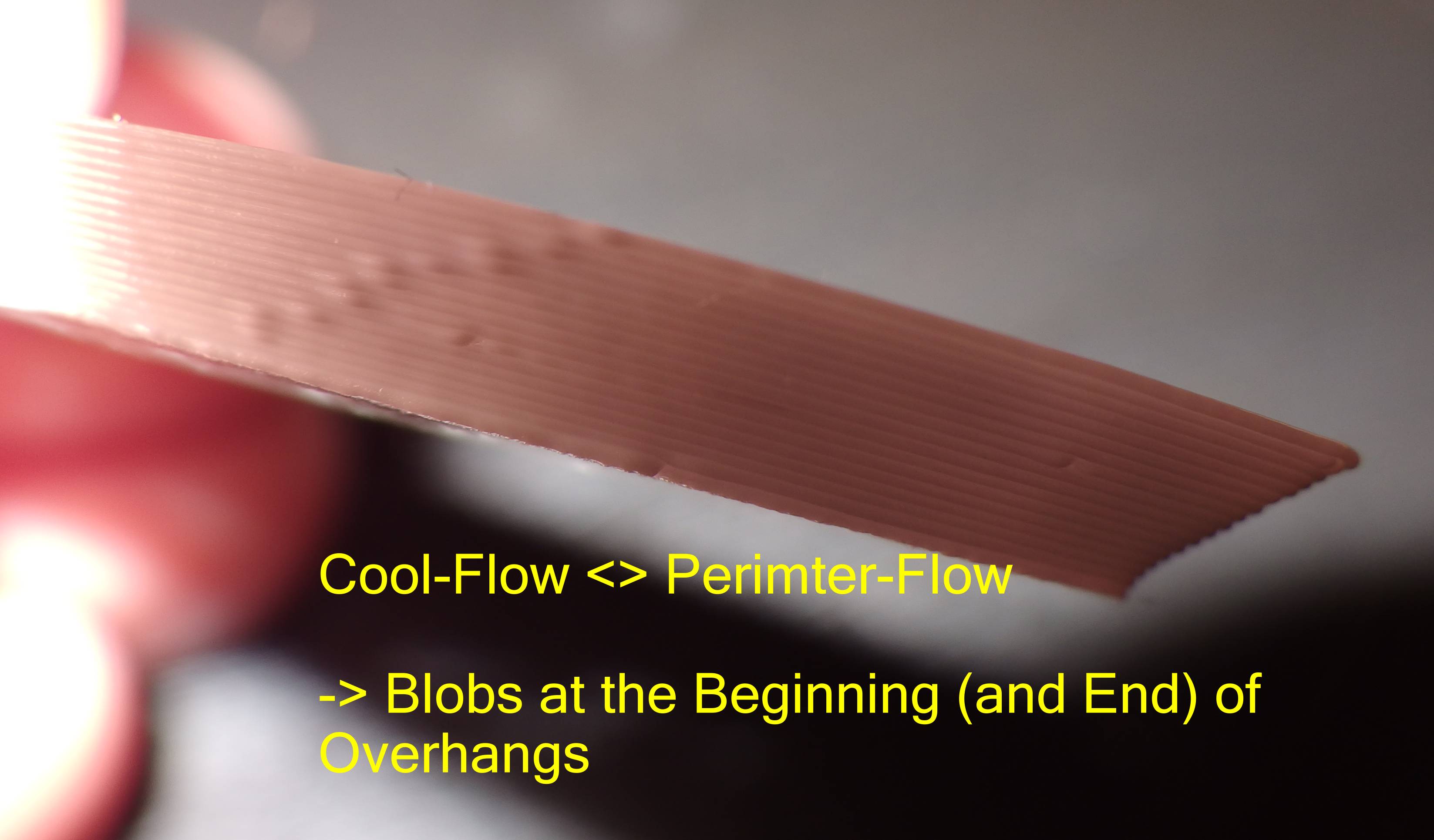

there is a bug in the Overhang-Feature:
For example, if your Perimeter has a flow rate of 2.0 and the "Cool-Parameter" (for overhangs) has a flow rate of 1.0 then
the flowrate is never going down to 1.0 in the overhang-area.
At the beginning of the overhang-area the flow goes down and up (results in a blob) an the overhang-area prints at a normal Perimeter-flow (not 1.0).
I analyzed this with the gcode and some graphical gcode-viewer.
Only if you set the Cool-Parameter to the same flow-rate as the Perimeter-flow, then there is no stop and go and no blobs (and no overhang-feature).
If you set the Cool-Parameter to another value as the Perimeter (for example 2.1 oder 1.9), there is a stop and go and also NO Overhang-Feature,
because the Cool-Flow will not be used!

Cool-Flow <> Perimeter-Flow
Cool-Flow = Perimeter-Flow

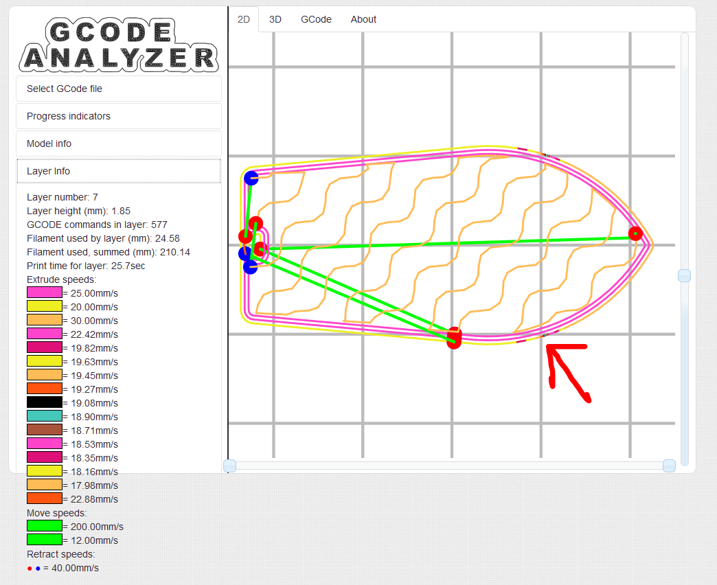

You have to check the stop and go with another gcode-viewer. With a gcode viewer which is showing speeds and not only coordinates.
Like this one http://gcode.ws/.
Here is a screenshot...there you can sie the blob graphically:

I made a testprint...absolutely no change in code and in the result.
Also with the choice of only one extruder there is a stop and go on the begin and the end of an overhang area.
Also, please remember that the speed decrease (and fan increase) for overhangs does depend on the amount of support from the previous layer.
I hope you understand what I want so say:
It's okay when the printhead slowdown into an overhang area and speeds up after an overhang area. But Kisslicer slows a little bit (not to the cool-flow parameter) down and speeds up again before an overhang area (and after).
Even tough the Fan can fully cool the filament or the overhang angle allows to only slow down a little bit...cause of the pressure in the nozzle, the blob will be set with this behave.

There is a slight slow-down, but it is very slight and there are no pauses. Unless the fan speed changes are causing your printer to pause.
I wonder whether it would be possible for you to edit the G-code and print the result:
1. Remove the fan speed changes
2. Remove the extruder feed changes at the pointy end
3. Remove both fan and extruder feed changes
As for your profiles - dual vs single - it would depend how your printer G-code is set up. I think that selecting an "Empty" material profile is probably your best option.

I generated a gcode-file with KISSlicer and removed ALL M106-commands in the file...then no blobs are occuring.
So the problem is definitely at my printer/firmware.
When I don't remove the M106-commands, then you can notice a very very very short break at the M106-command-position (at the beginning of the overhang).
But...
I googled some benchy boats and there are more boats sliced with KISSlicer which has the same problem. So I believe that this behave could be normal or in other words, many printers have this very little break.
I guess that most peoples don't care about these blobs or they don't notice it. Did you print the STL from my first post on your printer? Do you have this blobs, too?
Is there the possibility to deactivate this fan control at overhangs to avoid fan changes during a perimeter-print?
It would be nice to force overhangs to the parameter "Cool-Flow" and let the fan force to the perimeter-fan-setting...originally I expected this behave from this parameters.
Thank you very much for the support!
Re: KISSlicer Overhang-Bug (All Versions + Stable Release)
OK, I don't know what your printer is, but I don't get this issue when printing with an "original" Prusa (Mk2/Mk) They run PR Marlin on a 2560 MCU.
With this, I know that the fan commands are implemented immediately upon receipt of the command and are not buffered, so any blobs would occur up to 10 moves before the actual position in the G-code.
Just wondering whether setting the Material "Cool" value to 60 (the same as the loops) would prevent your problem?
