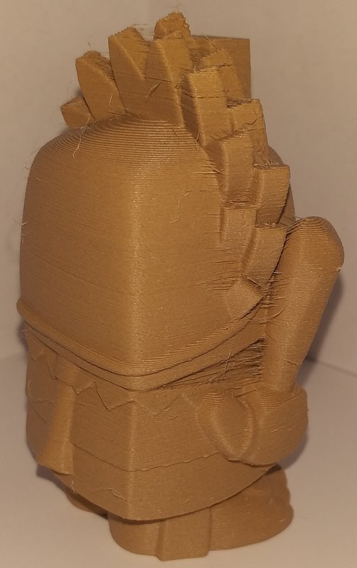

Here's a test print I did after a few hours of testing, calibrating, and verification. This print looks good. I see some small defects. However being a perfectionist, I want to tune out the wisps and get the print to be as clean as regular PLA.
Any feedback or tips are greatly appreciated.

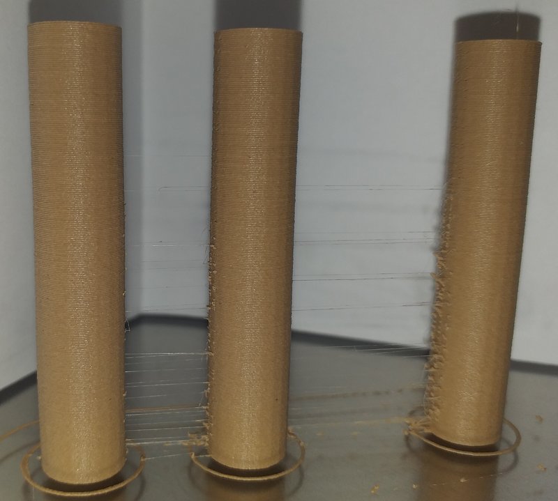

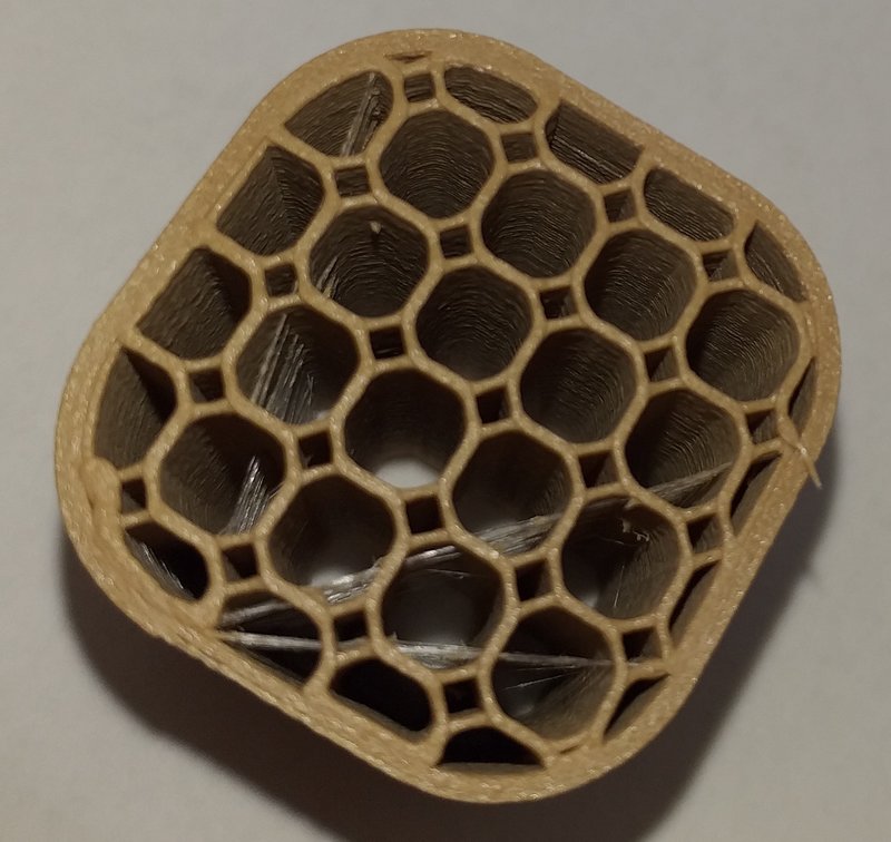

During my calibration of the filament I did the preload. I repeated the preload with Wipe turned off and Z-Lift turned off. I do like how the layers turned out but as you can see in the images below, At no point from 0x to 2x does the stringing become less. That is why in my previous post I had the preload set to zero.
The following are the preload test results. Bottom is 0x and top is 2x. I will repeat the Destring Test now with 0 wipe and 0 Z-Lift. I'll post those test results shortly.

It would be interesting if you could zip up and post some G-code.
There are still some faults in the alpha versions which may affect/contribute to stringing.

Hello Peter,pjr wrote:It would be interesting if you could zip up and post some G-code.
I'm running the stable release. Version 1.6.3
Here's the G-Code for the PreloadVE I posted previously. I am doing a few Destring tests now at diffent retraction speeds to see if the results change. The stringing is much cleaner now with wipe and z-lift set to zero. I will post my testing results soon.

FWIW, in that model there is no destring operating, only preload.
Not sure whether that's a fault in 1.63 of just the way the model is sliced. In any event, without the destring, there will be some stringing.

Hello Peter,pjr wrote:FWIW, in that model there is no destring operating, only preload.
Maybe a little miscommunication. The G-Code I posted was for the Tuning Wizard - PreloadVE. So yes its supposed to have only preload and no destring.

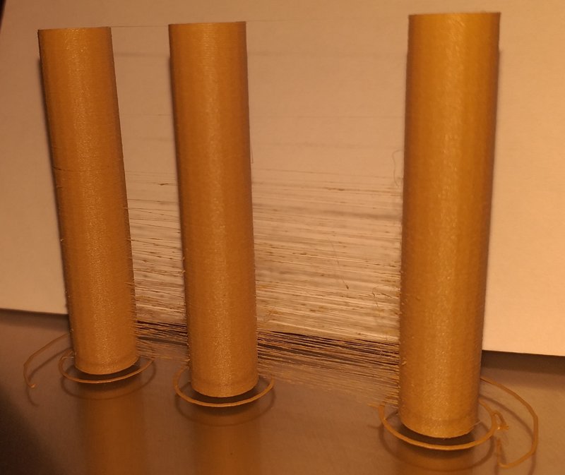

Hello All,

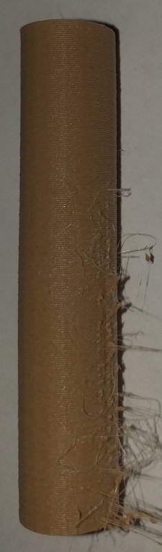

Based on the tips from Peter I reran some test. The following Tuning Wizard Destring tests were done with 0mm Z-Lift and 0mm Wipe.
The following test was done at 60mm/s retraction speed. After 35mm [or when the retraction is 4mm] the stringing stops. I also checked the third/last pillar in the row for defects to confirm this. Becuase Peter mentioned that slower retraction might be best for filaments like wood PLA. I repeated the test with retraction speed set to 20mm/s. After 35mm [or when the retraction is 4mm] the stringing stops just like the previous test. I also checked the third/last pillar in the row for defects to confirm this.
Based on these test results. I concluded that the retraction length should be 4mm and the speed doesn't seem to matter. I repeated the test but set the retraction to start at 4mm and stop at 5mm. The test results were clean. No stringing at all.

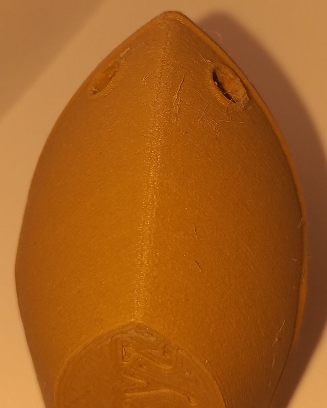

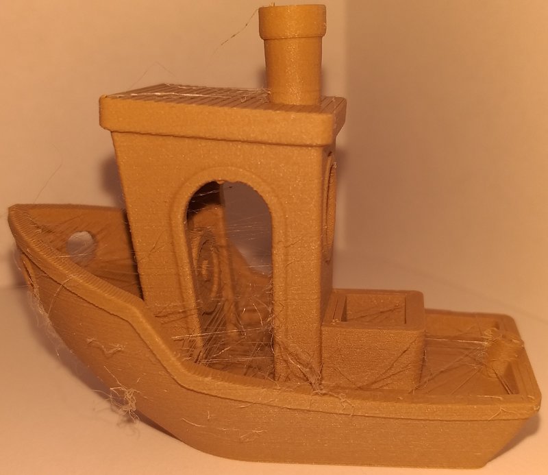

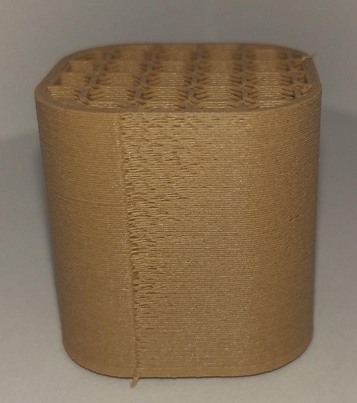

Now with the settings for Hatchbox Wood PLA dialed in as tight as I can get. I did a few test prints. The first print was done with Z-lift set to 0mms. This was very interesting to watch but also nerve wracking. I was constantly worried the hot end might bump into the print and it would fail. I sat next to the printer for the whole print. The Benchy turned out amazing. Ignoring the very fine wisps the quality is great. The Surface finish is amazing!
Print 1 - 0.2mm Benchy Circled in blue, You can see the seam scar.
In KISSlicer I did set the seam to be at the front of the model and jitter set to 0. However the seam was across the side like a scar. This might have been a bug in the slicer as the 0.1mm Benchy doesn't have this issue.

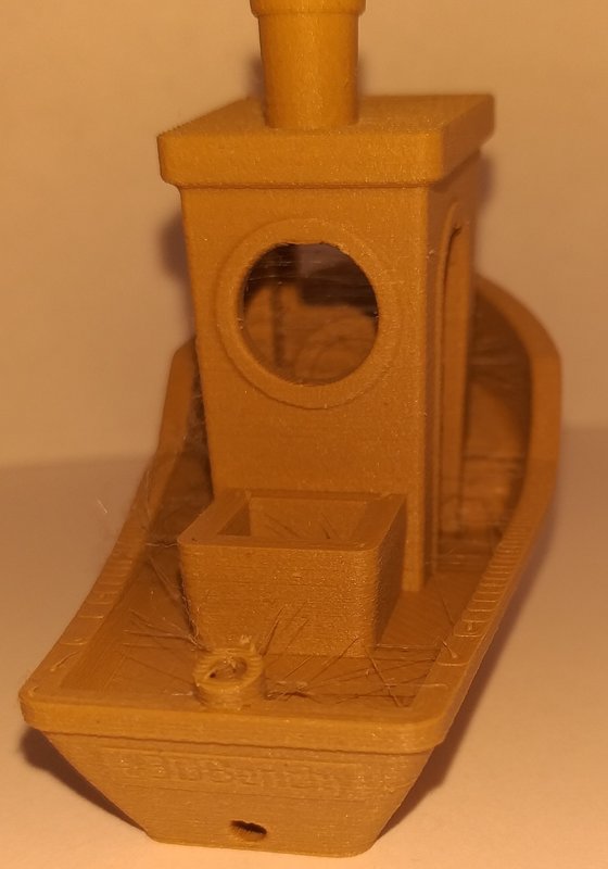

With the successful print of the 0.2mm Layer Height Benchy, I wanted to push the quality further and decided to reprint at 0.1mm Layer Height. For this print I set the Z-Lift 0.2mm. I did this becuase I feared the hotend crashing into the print.
Print 2 - 0.1mm Benchy I am very satisfied with these settings and I do not thing I can completely remove the remaining thin wisps of filament but I can live with that.
The following are the settings I used for these prints. From this whole filament calibration process I learned a few new things.
- Keeping the Z-Lift as low as possible helps with the print quality and reduces stringing.
- As peter mentioned and my testing confirmed. When using filaments with a fill like wood, Wiping can introduce stringing.

- Posts: 704
Re: Filament Calibration - Hatchbox PLA
A couple of other things.
Retraction speed. This may be limited by your firmware and when you have set it to 65 mm/s it may only be happening at the firmware limit (which was 50 mm/s in early "original" Prusa printers)
Parts warping with Z-lift = 0; generally, if you have sufficient part cooling and don't print too fast, you will not have a problem.
