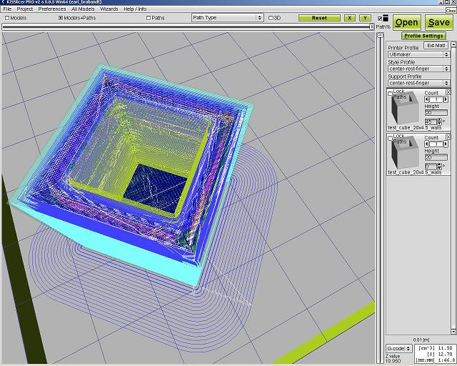

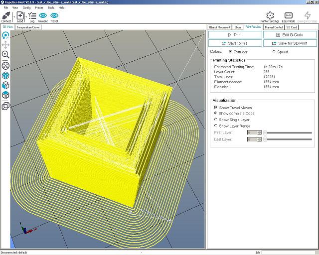

In trying to see the differences between [Style >> Travel >> Stay Inside] and [Style >> Travel >> Avoid Edge] gcode, I noticed that none of the Kisslicer graphics are displaying jumps above the bottom of this box in any of the viewing modes (Models+Paths or Paths with Extruder, Path Type, and with or without "3D" check, etc.) . However, Rep-Host shows the jumps:

This is 2a 0.6.5 Win64.

This path rendering bug still exists in both 1.6.3 and V2-alpha. However, it's possible to see true jump paths by using Rep-Host to examine Kisslicer gcode.
