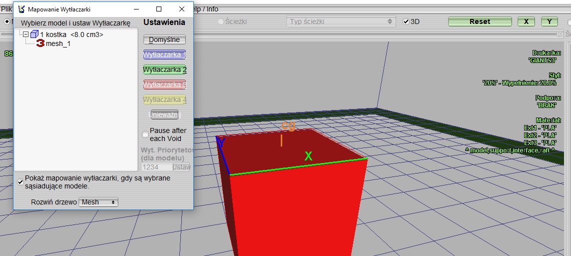

I created the third head.
I open the file and click on it and choose the third head.

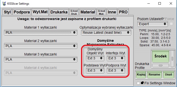

It does not work well. When I want to print from ABS and PVA, is T0 setting me 205'C instead of 245? I have defined heads in EXT MAP. What needs to be changed?
Re: Kisslicer Pro - IDEX
olo2000pm wrote:It does not work well. When I want to print from ABS and PVA, is T0 setting me 205'C instead of 245? I have defined heads in EXT MAP. What needs to be changed?
Please look at Settings/Printer G-code/Select New Ext & Warm
There should be something like this:
T<EXT+0>
