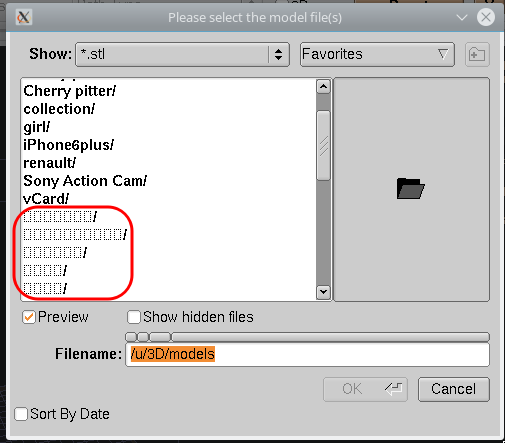

Hi. I try linux build 1.6.3 version.
Filesystem have files and folders named in russian language. But I see only boxes in list.
Is there a way to fix this?

I am working on a 1.6.4 release and would like to try to fix this issue...could you please try this:
[Project]->[Load Project / G-code Settings], then change the acceptable file type at the bottom right to "All Files (*.*)". At that point, can you see the filenames show up?
If that shows the filenames correctly then I know a workaround. If it doesn't work, could you let me know exactly which Linux build you are running? Maybe I can duplicate the issue on Virtualbox.
In the meantime, you should still be able to open files by dragging and dropping them from the file explorer to the preview window. And the command line should work as well.

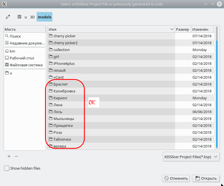

Re: Linux build filesystem encoding
Post by kyrilm »
Yes, this dialog shows correct file names

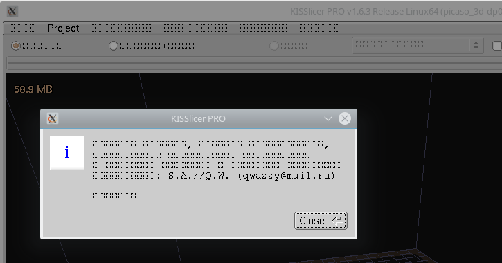

By the way. If I load russian translation file, I see the same problems in UI.
