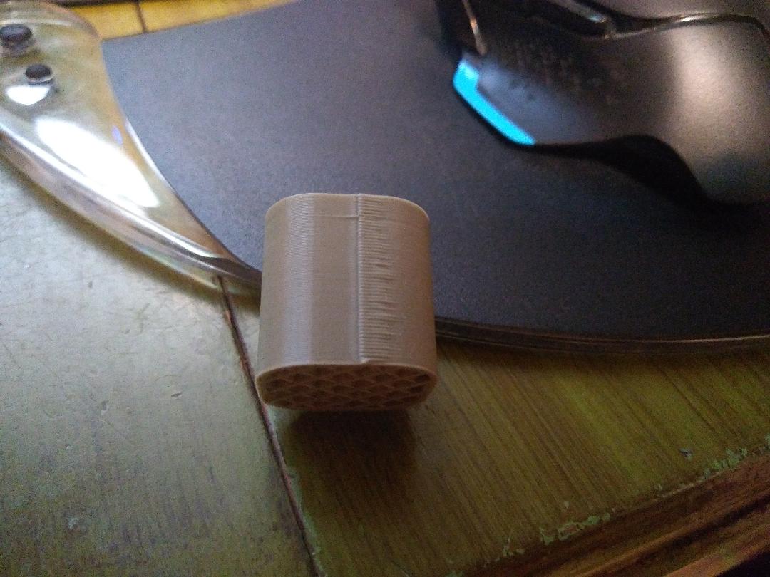

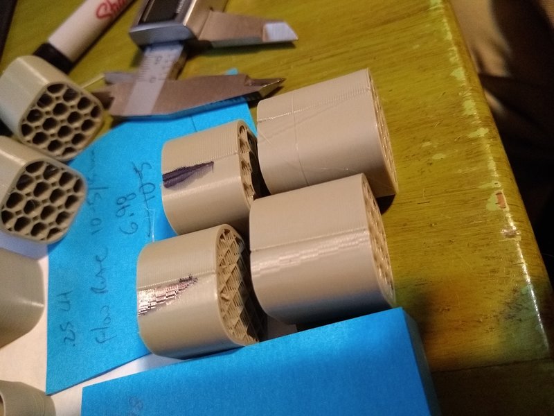

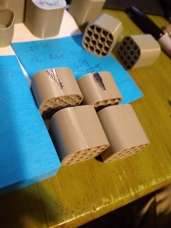

Hi I'm having trouble figuring out what to do next. This printer is a linear rail delta 300x500mm and 700mm bowden and duet for brains. I'm new to kisslicer (love it!) and have been going through calibrations in order for the last few days. I can't seem to be able to effect this little bump that happens at the beginning of preload (black sharpie lines to try to show the bumps). I have tried adjusting every setting/combo speed one at a time even firmware accell jerk settings but I can't effect the bump -only move it with increased speed. I have about a half kilo of testing cubes.. To me it seems like backlash or a lag and possibly it's always there just hidden in the z seam. I don't get the artifact when I use firmware linear advance (and it is off for these tests). I'm hoping someone will know what it is. I feel like I have exausted what I can do with settings and am starting to repeat tests. Going in circles my next thing to try will be to get rid of the bowden and try swinging extruder. I see the same bump in another post picture but they didn't use preload.? Am I lost o-0

hacker wrote:Unfortunately, I didn't keep my collection of test cubes, but at some point I started to get the same results, though never had time to figure it out.
Ditto.
My advice: If LA works well for you then use it with KISS. Put the K value into the material G-code and insert that into "Select new extruder and Warm". If LA has been properly coded into the firmware it should work better than preload. Preload is only effective at the start and end of paths; it does not "know" how the hardware works (acceleration/jerk/etc). LA should (theoretically) perform better at corners and anywhere else acceleration/jerk/etc come into play, and should work equally as well at the start and end of paths.

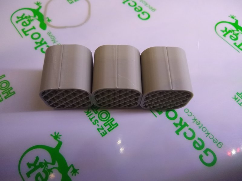

Throwing in the towel on this one for now but here are results from changing preload speed. vP mm/s left 5, mid 25 and right 35 - best I can tell observing the artifact happens when Pl first starts it's retraction but my extruder train 3to1 geared was at it's limit or at least sounded like it.

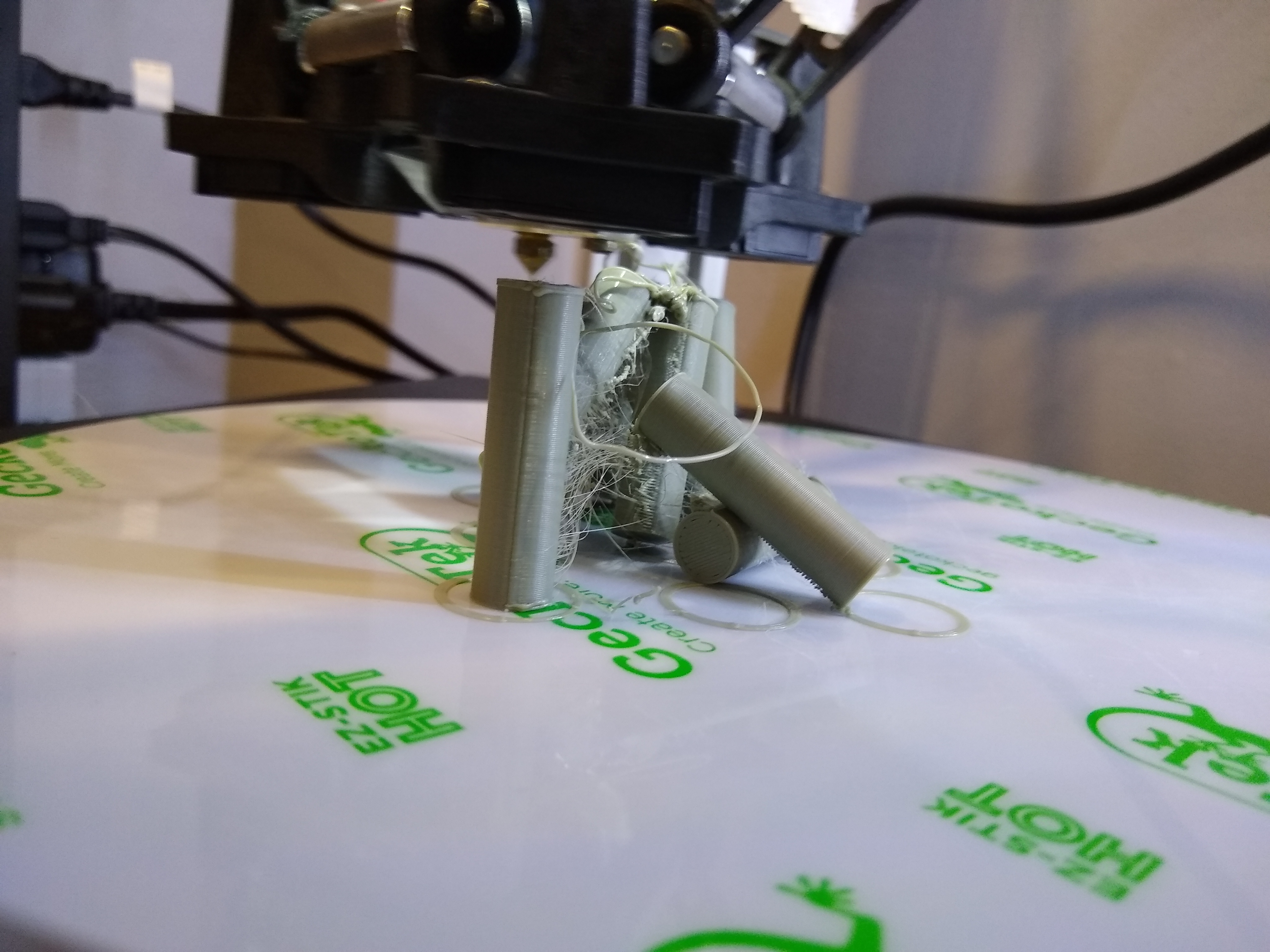

Here's what happens when you try Duets pressure advanced (0.08) with preload test :o. I was running through extruder jerk Accel testing and kicked in PA at the top it got wild e stepper was screaming and with no hop knocked down the towers 8-) . I may have seen some progress just before I wrecked it really limiting E jerk to 5mm/s and E accell to 1000 but will have to try the proper model again. Probably sitting squarely in the insanity camp now - I am starting to think it's just the nature of remote bowden extruding.

No preload or retraction. I think its still there just hiding right at the seam so think Kisslicer just revealed the defect not caused it. Im not totally sure if I don't have a mechanical issue - manufacturer is replacing aluminum balls they are undersized and swing freely. I'm pretty new on a delta so half confused on chasing down problems. Though it seems that this artifact is caused by the extruder. I guess I will know more when I get bigger balls. :mrgreen:
