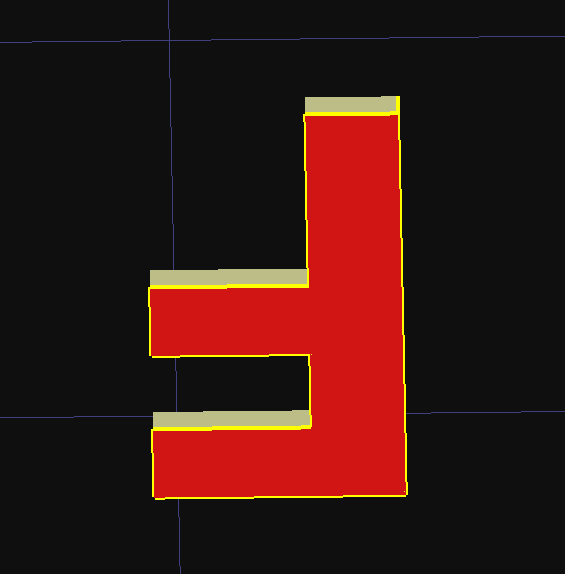

I reloaded some files in 1.6.3 successfully sliced with 1.5.1 and noticed some parts were showing major mesh errors.
This part, a letter "F" was the simplest example I could find. When imported it asks about voids (which it has none) and then shows an inverted bottom surface.
If I transform the part (flip upside-down) the errors disappear.
Inverted F.png (5.56 KiB) Viewed 3070 times

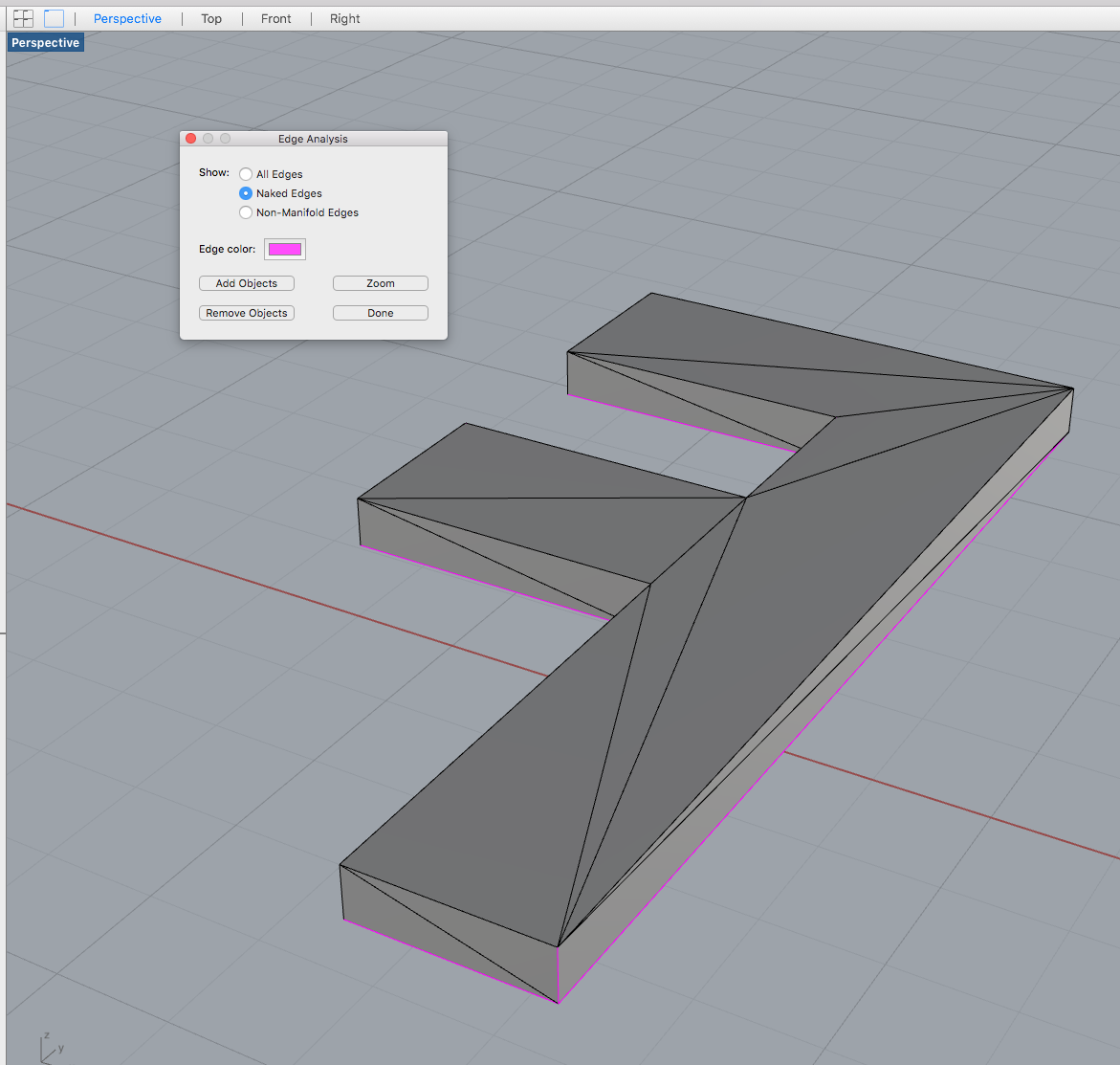

I use Rhino (CAD) for my design work for one very simple reason-it has excellent tools for creating and editing meshes. Here is what Rhino's mesh evaluation shows:
This is NOT a well formed STL, it absolutely has naked edges. The fact that Netfabb and makeprintable.com don't show this is troublesome.
Interestingly, KISS shows exactly the same edge issues in its display - that's a good thing.
cheers,
Michael
