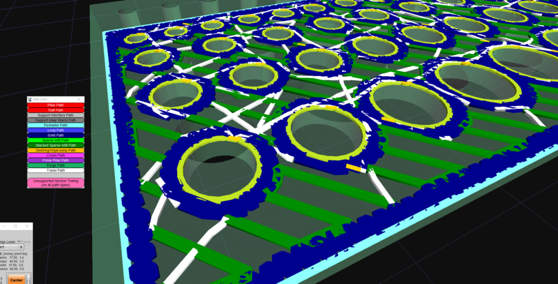

I encountered an issue that I also see with large negative overhangs. Kis produces a lot of unnecessary solid infill "spots" where they are not required or where the model no even has a hint why is should be there. See my example. It's a plate with straight up holes.
I need to mention, I did not activate / use fractional loops (which might explain the behavior even though it would be even more undesired).
Any ideas what is happening and how to fix it? I'm using KisSlicer PRO version 2 a 0.4.4 Win64.

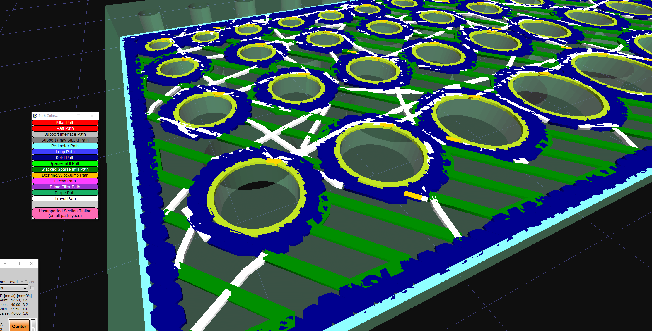

Please also note, that IF I activate fractional loops and set it to 2.5, every layer with 3 loops looks fine, while every layer with 2 looks awkward - which would supports my theory that this is a bug.
Please don't be confused. I DID NOT activate fractional loops for my first post.

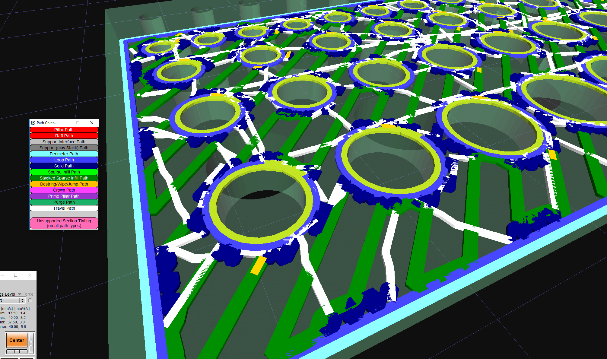

Also note, if I ONLY use 3 loops and no fractions, the slice looks fine! This only seems to be happening with one or two loops.
Here is a picture with only one loop - this will take forever to print and the holes will look ugly.
