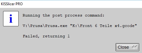

What is the meaning of this message?
Post by 3DBastler »
Error Message.jpg (28.63 KiB) Viewed 1847 times
It's just an example. This message comes each time I saved a sliced stl to my SD-card.
But while printing all is going well .
so what will this kind of message will tell me?
Re: What is the meaning of this message?
It means the postprocessor you have configured in your "Printer/Firmware" settings fails. How bad it is depends on why did you configure it and what it is supposed to do (I have no idea what "Prusa.exe" is, but then I'm not even a windows user).

Thank you. By your advice I found the problem here:
this one.jpg (173.66 KiB) Viewed 1818 times
The (now deleted) entry was directed to Peters settings where this profile originally came from. I overlooked that.
