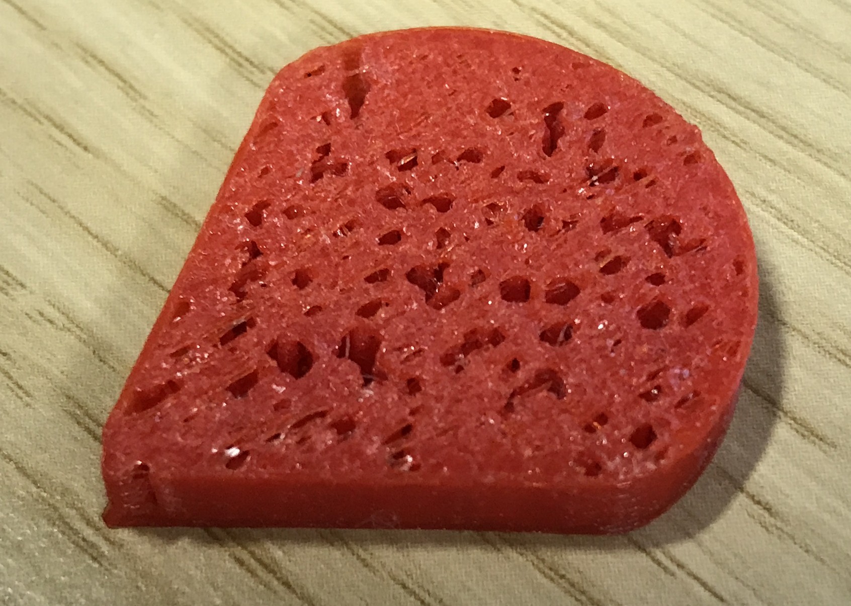

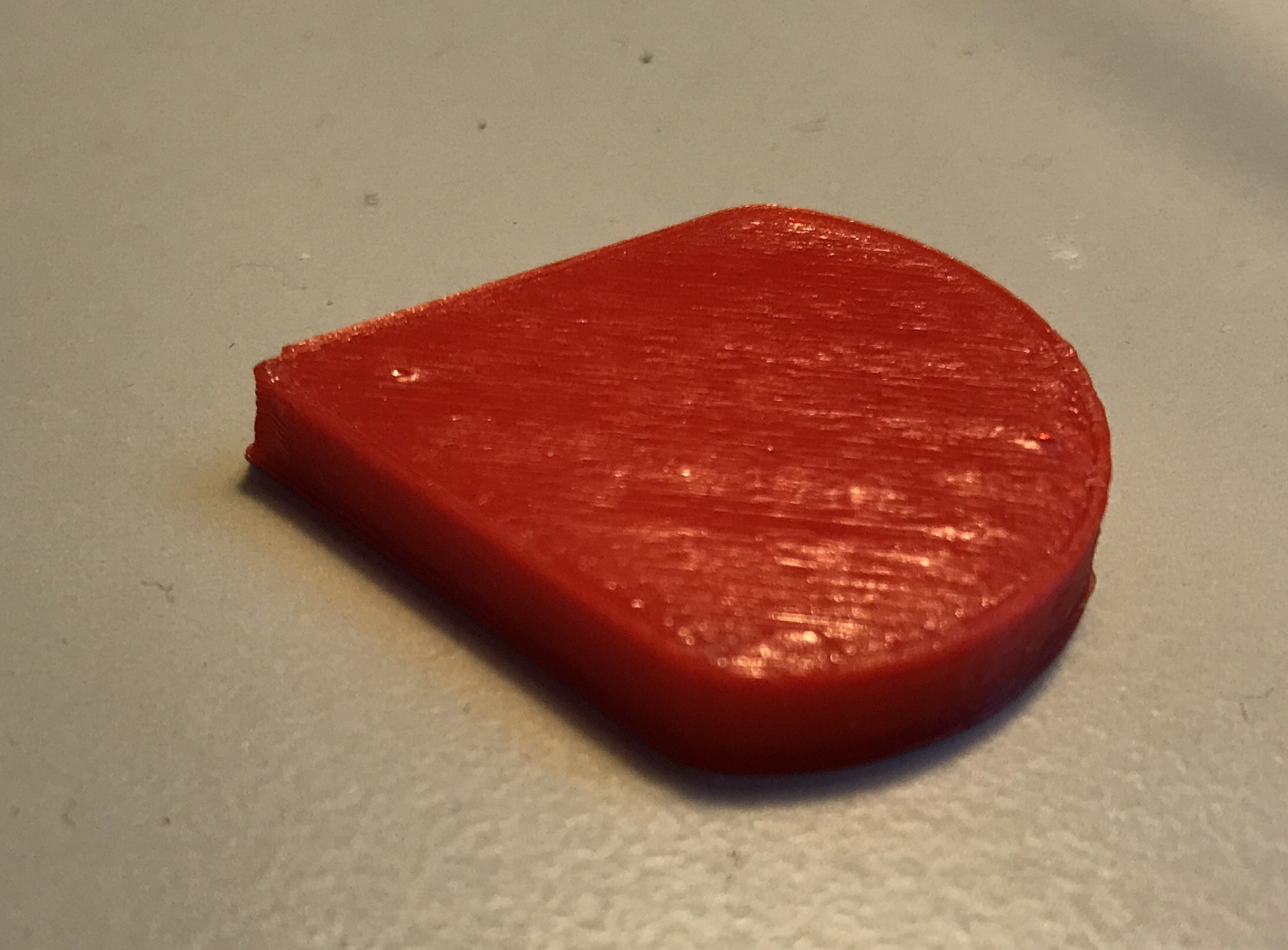

After some playing with the finetune model I ended up with this:
That is not perfect but acceptable enough that I went on with the print I had in mind.

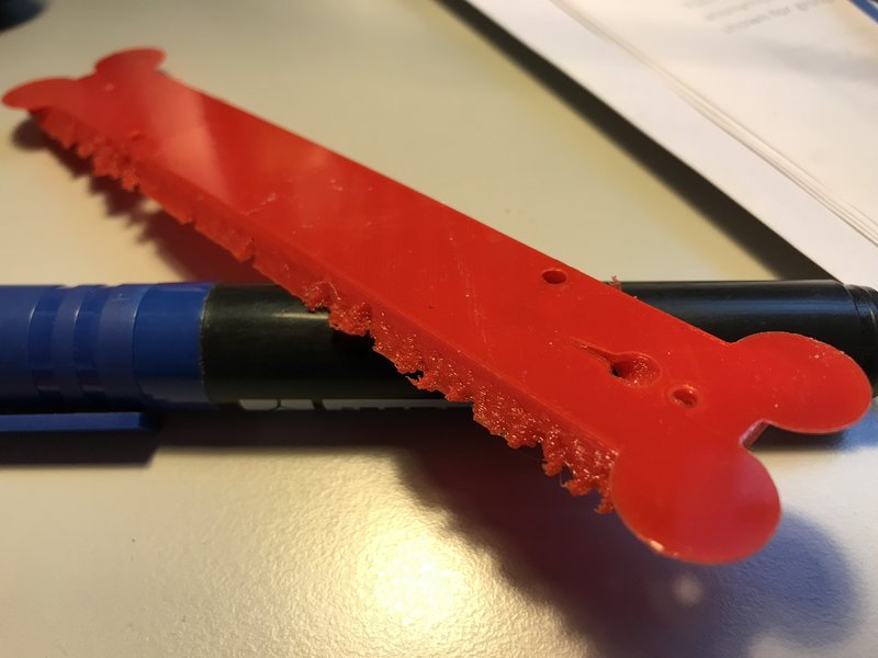

After some short time I saw that the long sides of my model were all a bit irregular. There is a lot of material missing in some spot. Here is a picture of the view from top:
The finetune model is added to give sense of the scale.
I also took a picture from below:
I struggle to understand the issue. During the finetune I tried to lower the thickness of the slice to 0.1 but was not able to get a complete top. When trying the prism with rounded corners in order to finetune the extrusion coefficient I saw that the walls were thicker than requested.
I do not understand if it is a problem of trying to extrude too little or trying to extrude too much. Changing the speed seemed not to have an effect on this.

by the looks of the print, you are printing too hot. ColorFab suggests 245-250. Your temp probe could be off from actual hot end temp. Try some test prints dropping the temp in 5-10 degree increments. Try that smaller print with 1 perimeter. If you can get that smaller piece with 1 perimeter, it should be good for the larger print with 2 perimeters.

Here is some feedback. I tried the "finetune.stl" by decreasing the T. I printed it with 250°C. In order to get the border with really one loop only I had to reduce the wall thickness and that resulted in a very bad top. The sides seem to right except for the part near the tip of the shape. There some material is missing.
I will run a 240°C test next. I still do not understand what is wrong with the top surface and why.-

Still looks too hot, maybe some under-extrusion. A .4 noozle should be able to basically bridge across the infill. try your skin thickness at 0.3. That should give a single wall, and 2 top layers.

This looks similar to the issue I reported (titled "Insufficient prime...", in Troubleshooting). It looks like your extruder isn't putting out filament until after the head has begun to move, leaving gaps where it starts a layer. If you have the jitter turned on so that the layer print doesn't start at the same place each time, the place where things are missing moves around.
I'm kind of disappointed that I haven't seen anyone with an idea for correcting this. Support of this slicer has been kinda hit-or-miss for quite a while now.
I am looking into a new slicer called Cura that knows about BFB printers. It will take some time to see if I can get a print out of it that will go through Cubeitmod and actually work on the Cubex; I'll post updates if things look promising.
