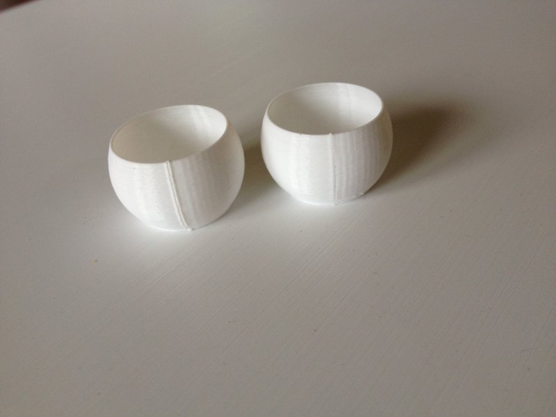

Thank you Peter, I've tried your tip:
On the left, best seam I could achieve (not acceptable), on the right everything to 0 and Off (even preload):
it improves things, but a real vase mode would be awesome, I can not wait for KS V2. I prefer using slic3r concerning vase mode for the moment.

For my project, 1 perimeter is what I needed and here's the result:
Re: Vase mode
That looks really nice.
I did a couple of prints, with 1 and 2 perimeters. The one perimeter print had a much better seam than the two-perimeter print.
