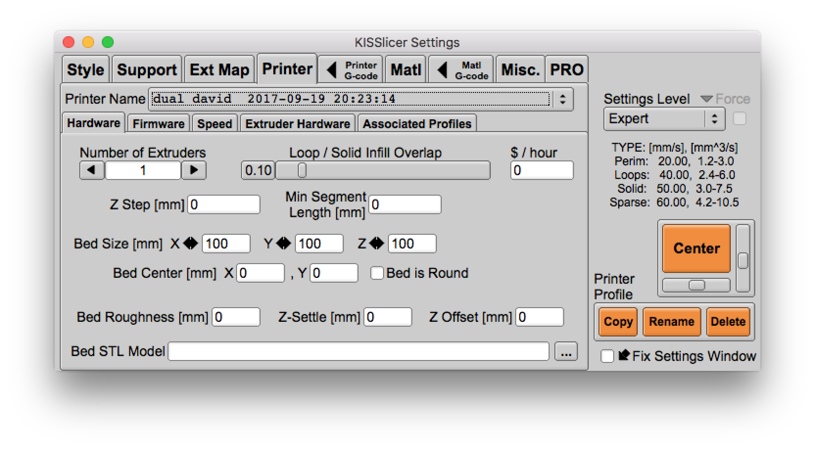

after I started KISSLicer today I suddenly discovered that my printer profile is kinda emptied:

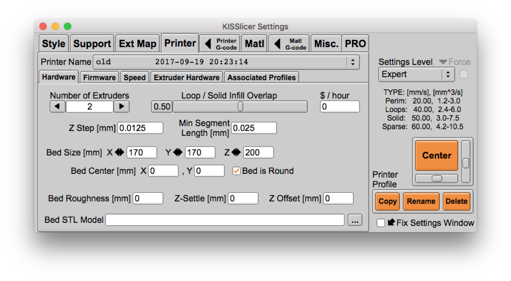

but I also discovered that now I have another profile called old, which looks more or less like the old profile used to look:
I certainly neither created new profile, nor renamed the old one. But what I did yesterday is renaming a bunch of material profiles adding '[old]' at the end (I reworked my printer a bit). And look into the _materials directory reveals:
-rw-r--r-- 1 hacker admin 996 Sep 19 20:23 'ICE ABS naughty natural (D0) [old.ini'
-rw-r--r-- 1 hacker admin 997 Sep 19 11:15 'ICE ABS naughty natural (D0) [old].ini'
-rw-r--r-- 1 hacker admin 1004 Sep 19 20:23 'ICE ABS+ cunning clear (D0) [old.ini'
-rw-r--r-- 1 hacker admin 1005 Sep 19 11:15 'ICE ABS+ cunning clear (D0) [old].ini'
