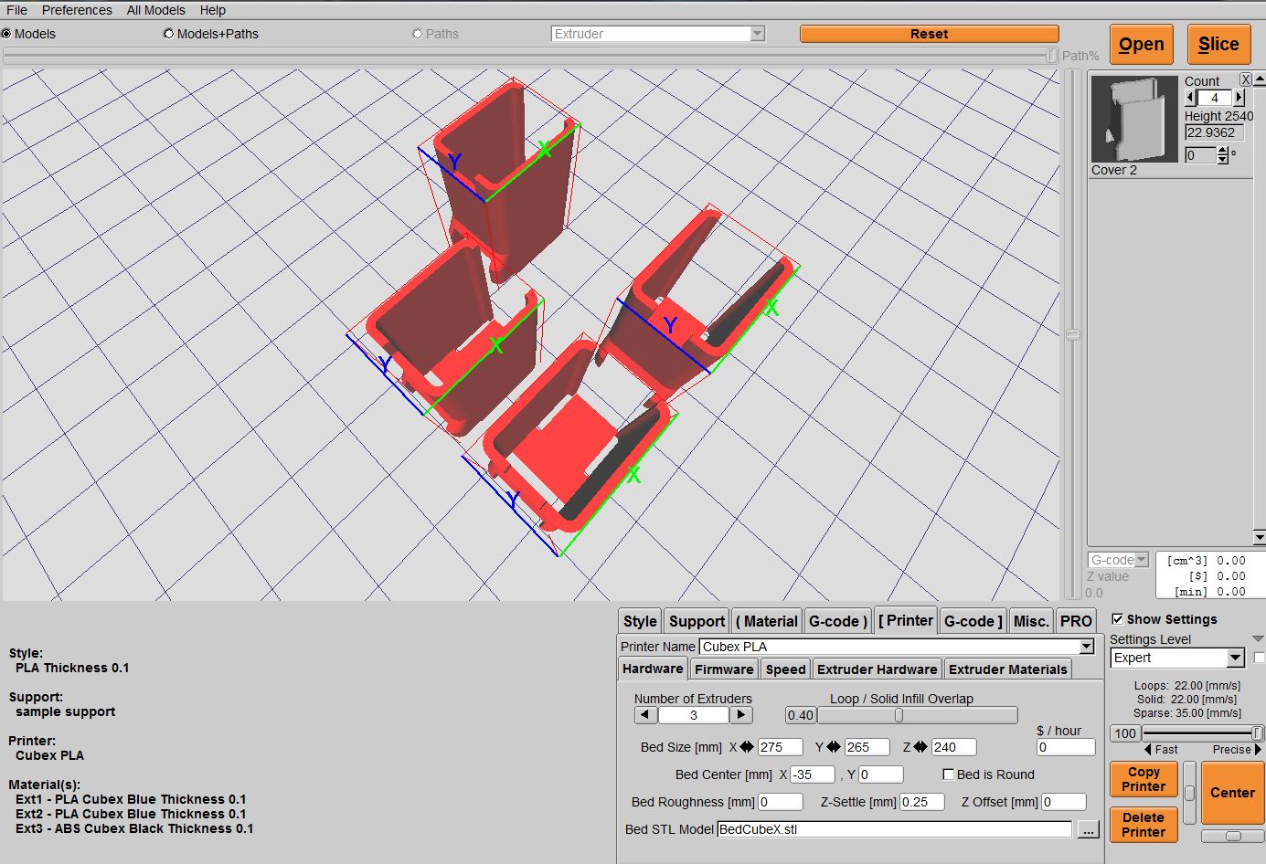

Not sure why it put a big gap between the 3rd and 4th part, but I guess not that big of deal. Just strange.
