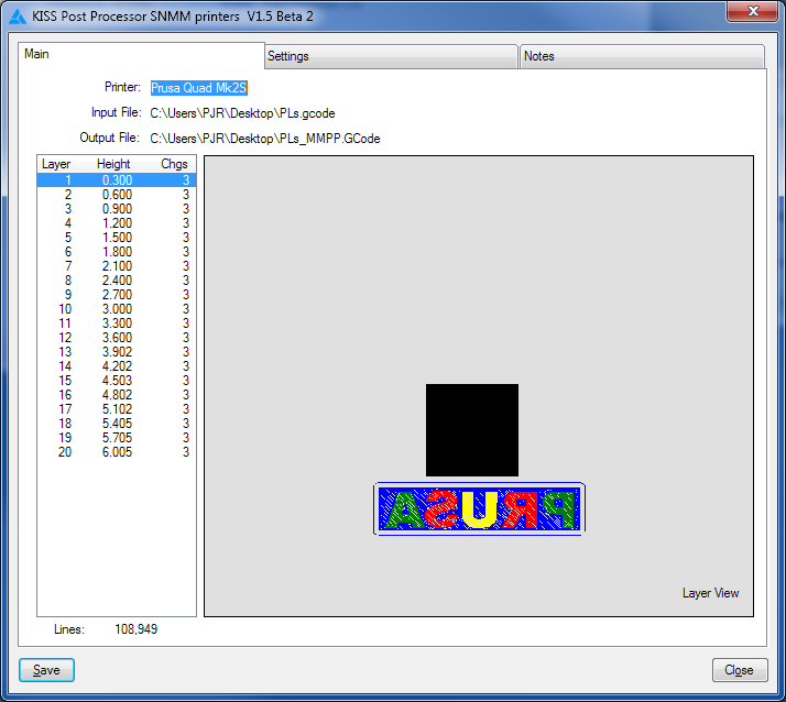

PrusaPP post processor "Main" tab
Once a valid G-code file is loaded, a window similar to the above will be displayed
The list box down the left hand side displays the layers of the model and selecting any one of them will display in the main area what is to be printed for that layer.
The position and size of the purge tower is also displayed in "layer view". This is determined automatically during the initial loading of the G-code.
Left-clicking the main display area will generate the above display, which is an overview showing the whole model.
WARNING: Do not change between layer and object views or select another layer during the saving of the processed file. This is something that I need to disable within the program.
Please note that being intended for the Prusa Mk2/S + MMU the bed display is fixed to a specific size (250 x 210) and may not match the size of your bed.
