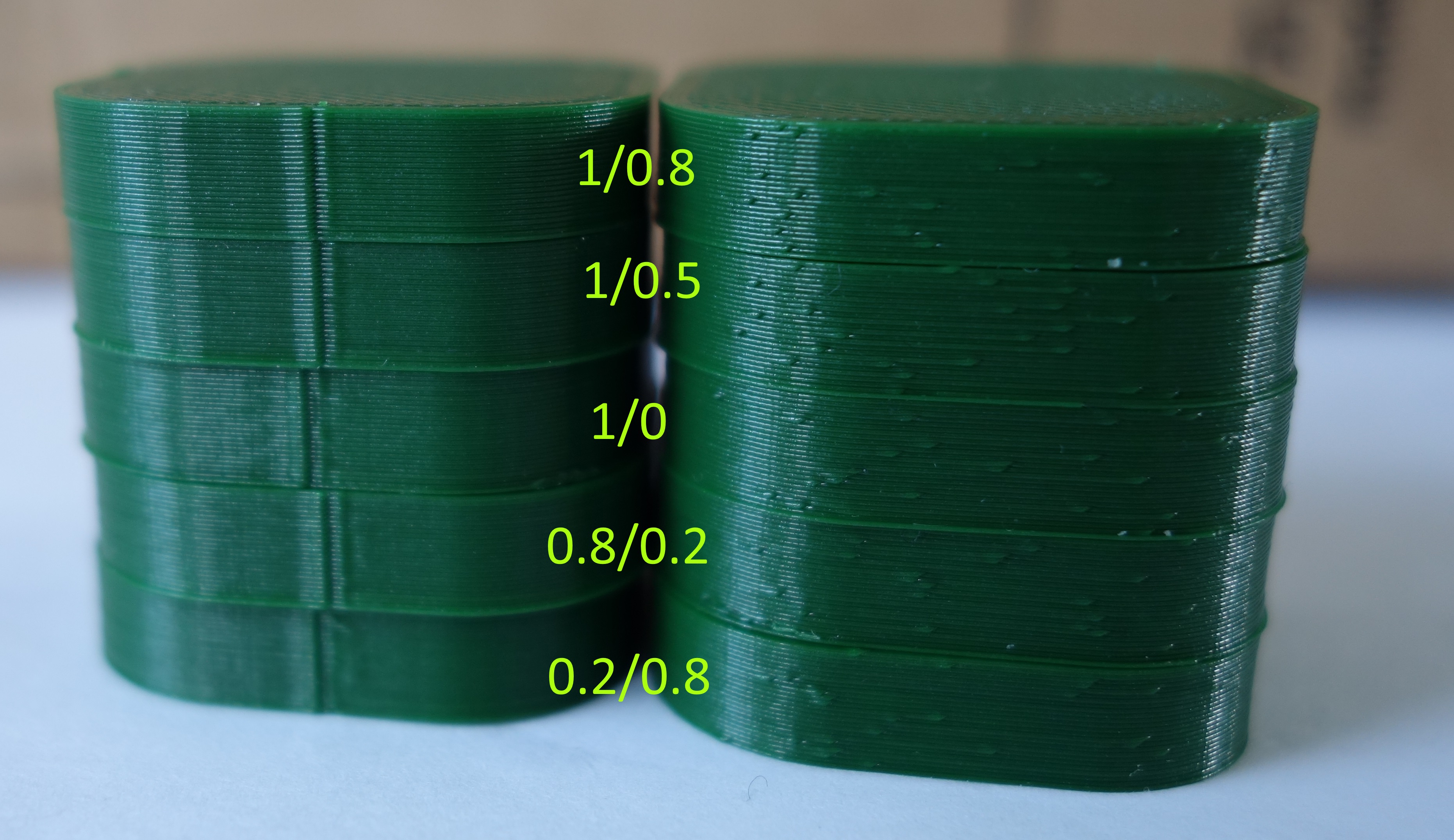

I'm also struggling with the seam hiding feature switching from slic3r to kiss
Preload results in this After setting the value I'm trying to find the best settings for seam hiding. I'm using the values from Peter, Jonathan and
Michael to getting a starting point. Maybe I'm doing something wrong, but changing the parameters don't show me a
direction to getting better results. Values in picture are for depth/gap, left join-loop "off" and right join-loop "seam",
3.5 loops, loop1>perim, PLA, Pi3 MK2s.
Any hints?
thx, Alex
