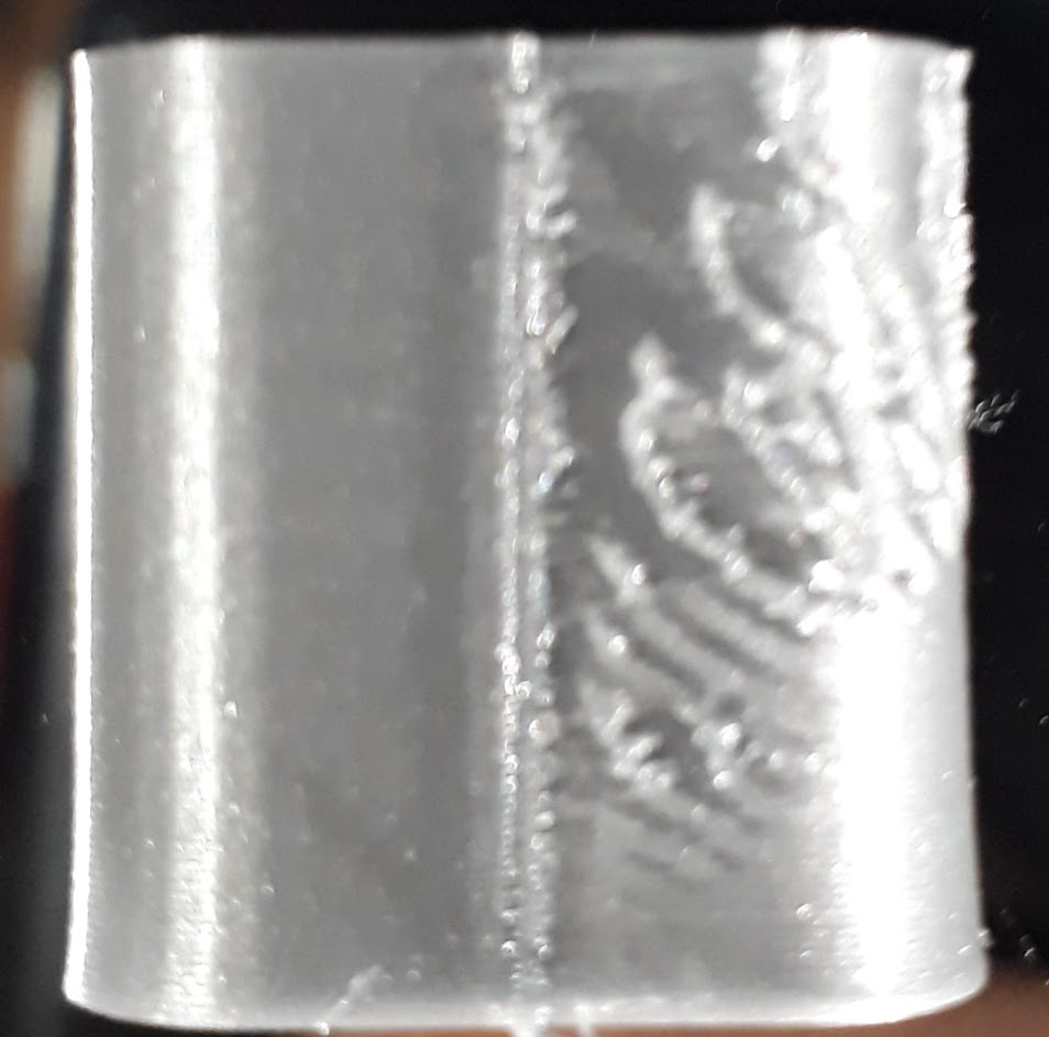

Just ran the preload wizard, here is my result. I see no changes along the Z axis

I'm not quite sure what difference I should see. The tuning part is quite a simple model, so I can't imagine what would look bad on it.

Thanks, slicing and printing now. What is it i'm looking for though? What should idea look like?
Re: Preload wizard - what am I looking for?
vibez wrote:Thanks, slicing and printing now. What is it i'm looking for though? What should idea look like?
Look at the seam. You will see a "sweet spot" where the seam is near-perfect.

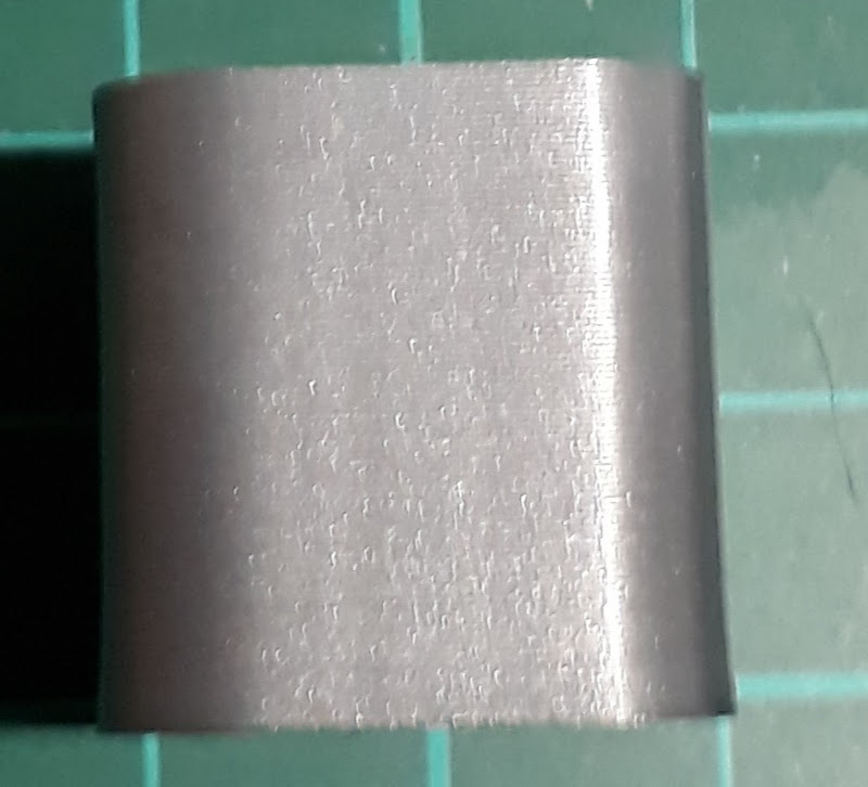

Hmm, not so good
Yeah, that's fine. What min and max limits did you set?
