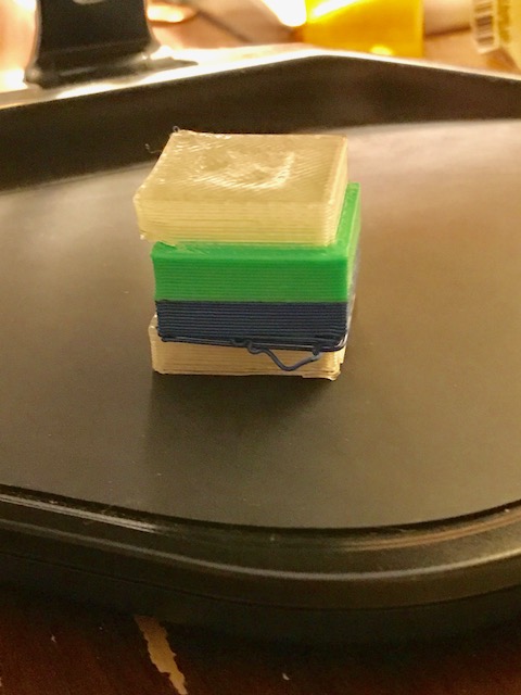

I've attached a picture showing what the printer is doing. This is a 1x1x1" cuber divided into 4 parts.
- Jet 1: White PLA - layers 1 and 4
- Jet 2: Blue ABS - layer 2
- Jet 3: Green ABS - layer 3
As you can see, Jets 2 and 3 are perfect... just Jet 1 is offset from them.

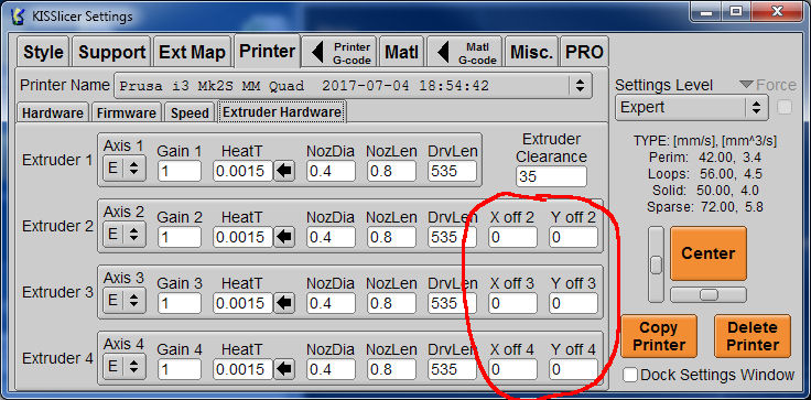

Re: Jet (Extruder) Offset Calibration
Sorry, I don't know your printer, but I think the settings are in Printer/Extruder Hardware tab:
